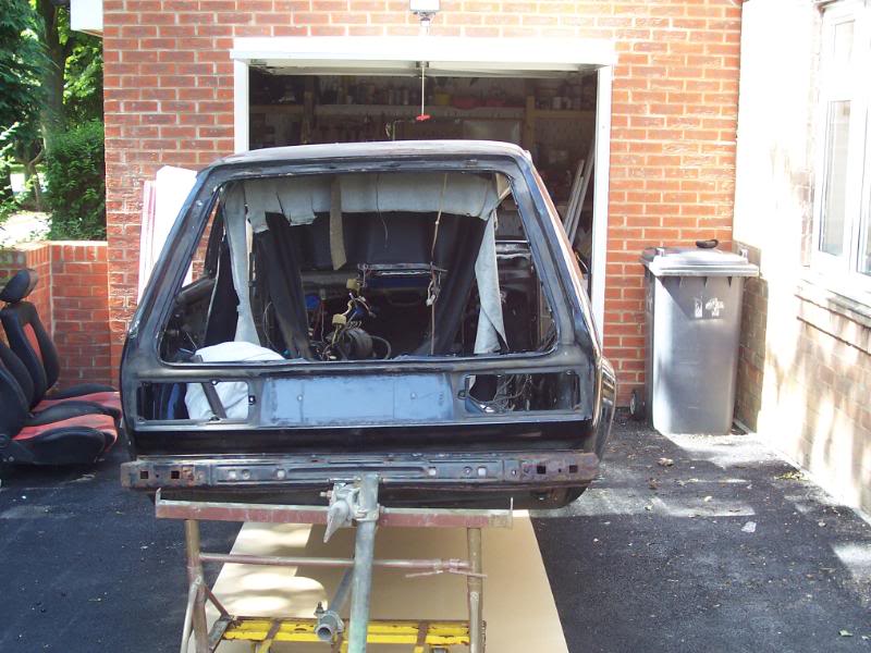

Its an '83 Campaign, 2 owners from new, last owner 19 years. Apparently and Englishman working out in Germany ordered it whilst over there and brought it back with him. He kept it for 5 years then sold it to a doctor who lived about 7 miles away. I bought it from him, he lives about 7 miles away from me!! Yep it was originally from my home town.
It looks like a full, comprehensive restoration is on the cards now. Mainly stock. So here goes………
If your thinking 'that looks like an old builders tressle, a few scaffold tubes and fittings and a cart for moving around bread trays' you would be correct :wink:

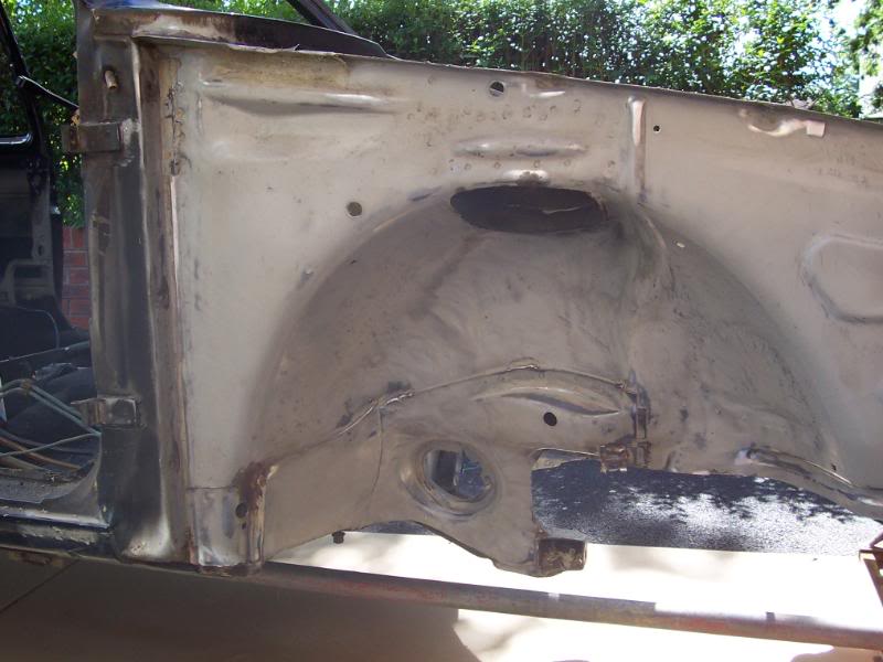

Inner wing stripped of underseal
One side of the floor pan virtually done
A bit of rot on the drivers side sill cut out ready to patch
Pressing is rough and dented, so thats coming out too.
This is the rest of the rot on the drivers side. Arch is gone, flange on inner arch where fuel pipes go through is crusty and a hole next to the fuel pump mount bolt. I havent really probed too hard elsewhere yet. Just going to work my way around the car.
Engine bay done but going to do it again and completely strip factory underseal off right down under chassis rails 8O

This is the sill that was shown in the first post. Tiny hole to 'spot up' still.
Replaced this bit too because the pressing was flat.
Metal was a lot thinner here so i had to cut it all out.
Made this plate with a return to replicate factory and also prevent fuel pipes rubbing on an edge.
In place.
Fabbed his for chassis rail, with captive bolt for fuel pump bracket.
In place. Needs a bit more 'dressing'
Started cutting the rear arch out so thats next.
unmol said
good strart! what did you use to get rid of all the under seal
The best method i have found is to heat and strip the bulk of it with a blow torch and then remove the rest with a wire wheel on an angle grinder. Its slow and laborious and im really not looking forward to doing the other side!! Be very carefull if you use a blow torch, underseal will burn merrily if you dont keep a close eye on it. I always have an extinguisher to hand.

reg said
I'm using a one of these
http://uk.four.ebid.ne…3&mo=auction&from=froogle
or the cupped type.
Keep up the good work daz.
Yeah, thats what i use. Cupped type on angle grinder. Very good!! Slow but steady progress Reg, hows yours coming on?
