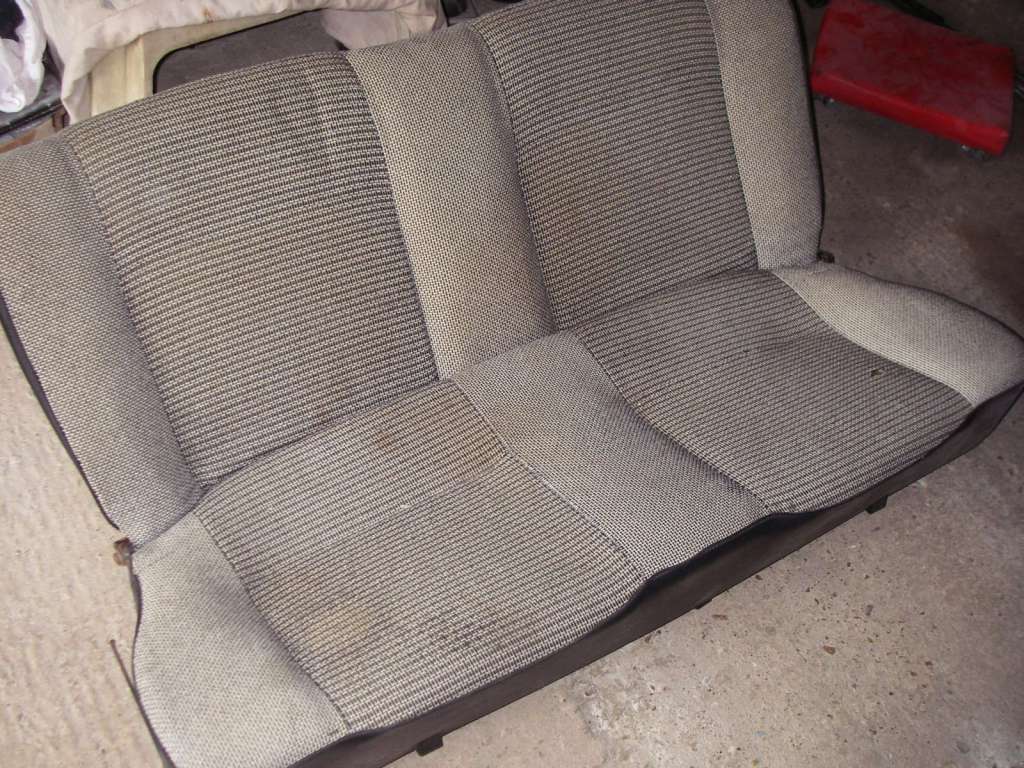

So the cars at the body shop and have spent most of today tidying up the garage and sorting what bits and pieces I’ve got, good news is that I managed to unearth the seats and no little mice have made their home in them, will just need to get the rear bench reupholstered to match whatever front seats I decide (can afford! Lol) to put in it. Also came across the cylinder head I had skimmed and pressure tested absolutely ages ago and also had a quick go at finishing stripping the block down to paint it although one dam bolt just won’t budge! Applied some force as well as plenty of WD-40 although the little monkey just didn’t want to move soooo I’ve left it to soak for the time being, if it still won’t move then I’ll have to drill it out and re-thread a new thread into the block.
I had done quite a lot to clean the block already so once everything is removed shouldn’t take too much to finish it off then paint it. Also found the cheap second hand tyre I’d bought off evil-bay to put on the alloys I won to check and see whether they fit on the car, seeing as they’re 9” wide I’m doubtful they will but I will see. I’m going to try some 215 40 16 tyres on the alloys and if they don’t fit then they will be sold to make way for some that will as there’s no way I’m going to run stretched tyres on the car, anyway a few pics……………
