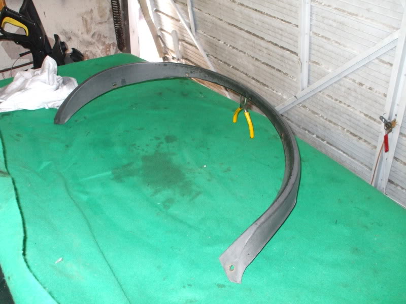

started with arches, as you can see they have gone grey,

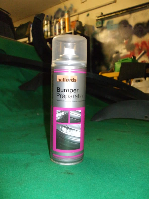

so firstly clean them up with halfords bumper preperation (£5.39 bottle)
then get a arch ready to spray

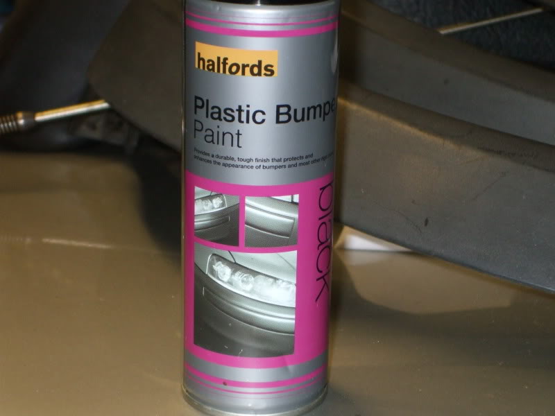

iv used halfords plastic bumper paint in black (£5.89 bottle) only one bottle was used for the arches
