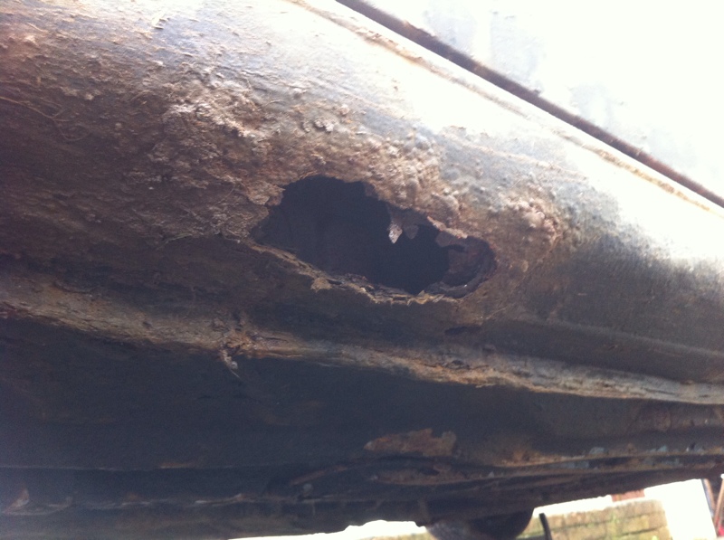

I should mention, it has no MOT and has been off the road for 3 years so the good old tin worm has been doing its thing.

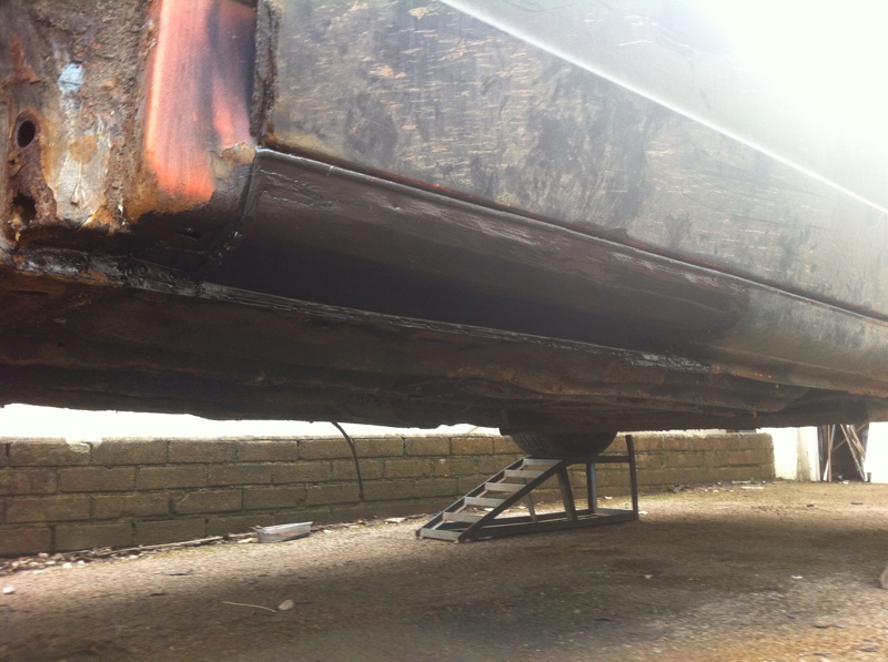

Off side sill
Last edit: by andy6693

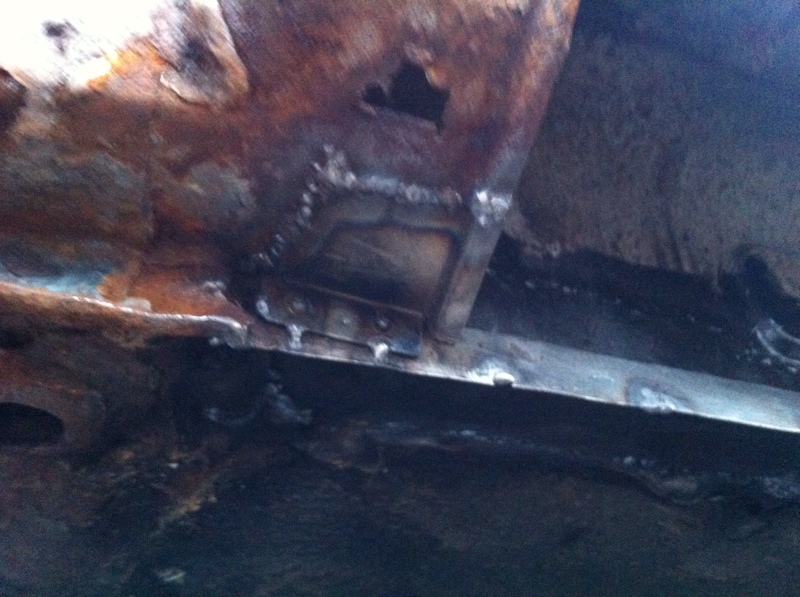

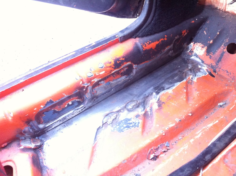

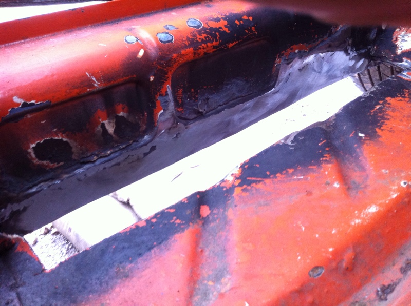

Started making good, I ended up removing more metal than I had planned but isn't that always the way
Inside finished
Welded
Ground and painted, not the prettiest repair but it is all solid and when its on the floor you will hardly notice it, cost me nothing though so can't grumble

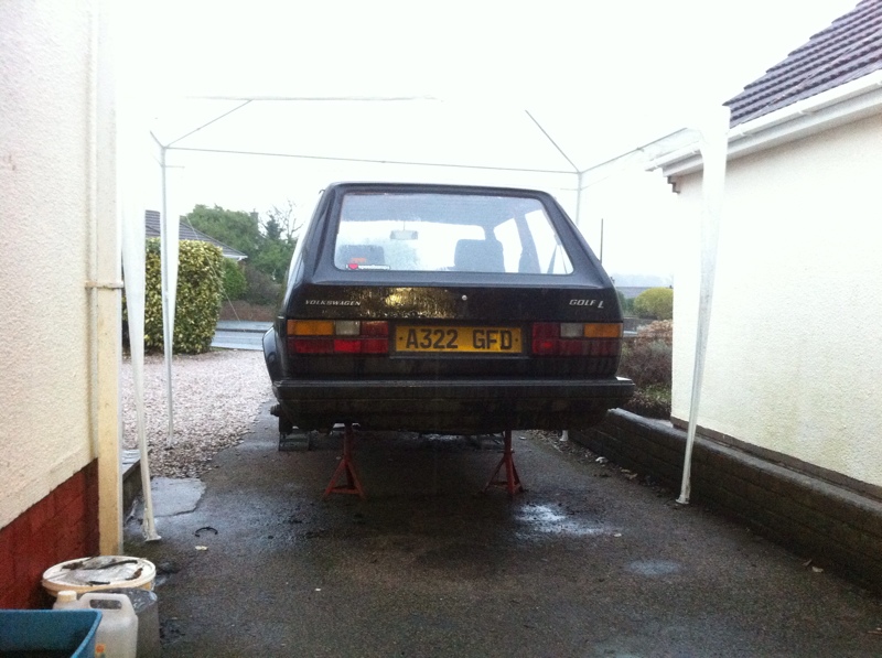

Here's just a quick shot under the gazebo that kept flying away
More tomorrow.

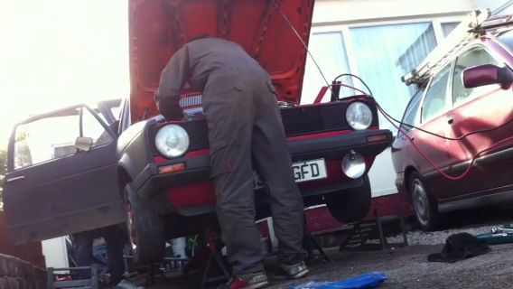

I then replaced the off side front brake line, solid and flexi as it runs along the bulkhead and it would be easier to do it now before fitting the manifolds.
Then came the task of mounting the new down pipes to the manifold, its the c clip version and I have read you need a special tool (which i didnt have) but 2 people and half an hour later we got there.
Mounted the GTi mid section of the exhaust and propped the old back box in place (its shot so will be replaced)
Then came the moment, time to start it after mounting the inlet and carb, turned it over without the plugs to get the fuel through and then put the plugs back in a went for it. Made a short video because I can. I'm quite pleased with how it runs although there is a slight problem with how it turns over. Either the styarter is a bit iffy, or the battery isn't man enough. Maybe someone can suggest what battery should be fitted?

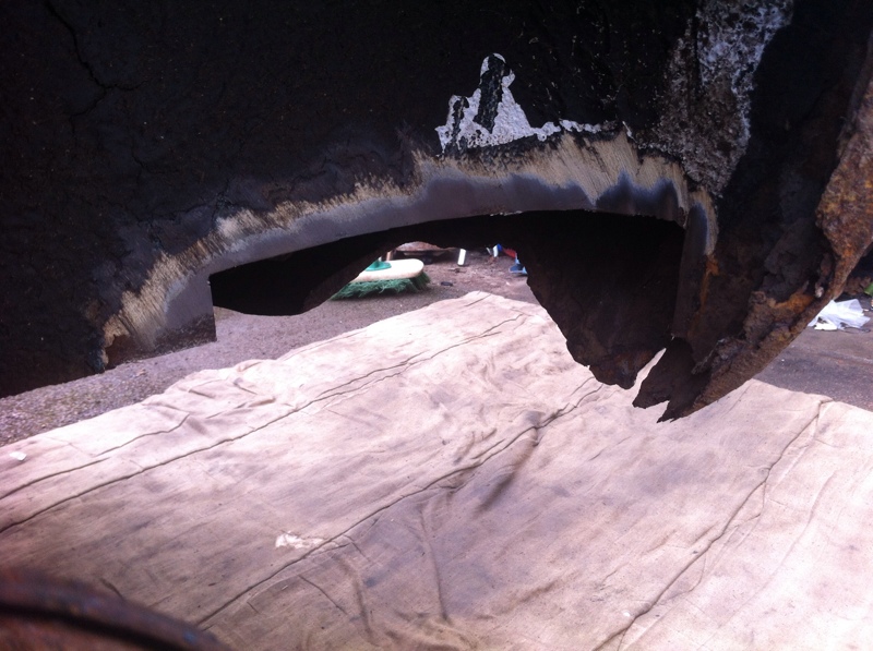

Then I found this on the rear chassis leg when I went to mount the exhaust back box.
So I did this
Then this
To this
This is the chassis leg fixed, I cut all the rot out and made up a repair panel which I havn't got any pictures of but here it is welded, painted, seem sealed and the exhaust hanger welded on

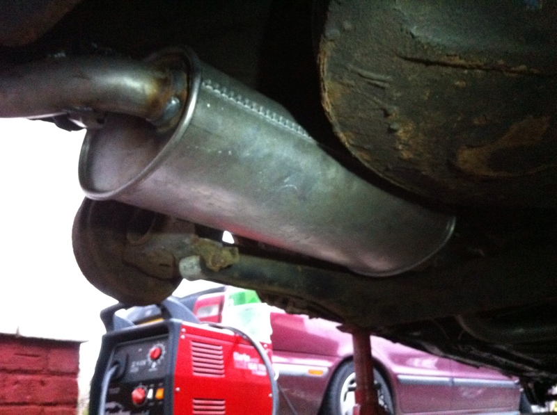

And mounted the GTi back box
