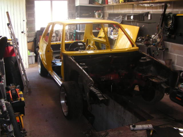

ok so i moved the car in to the garage
Ok bearing in mind i have no mechanical training whatsoever i dived straight in I mean really how hard can all this be(I was about to find out)
the begins

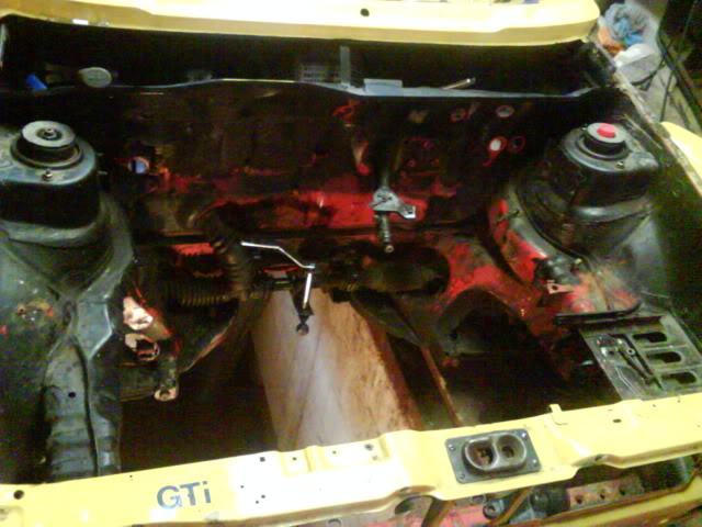

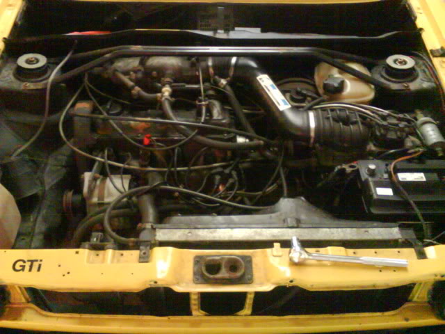

ok so with the majority of the external stripped it was time to look at the engine bay,so out came the engine
I got the engine out on my own with no crane managed to lower the engine to the floor then lift the whole car over it, not the easiest option didnt quite realise just how heavy they are.

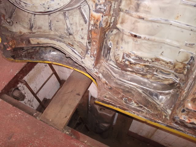

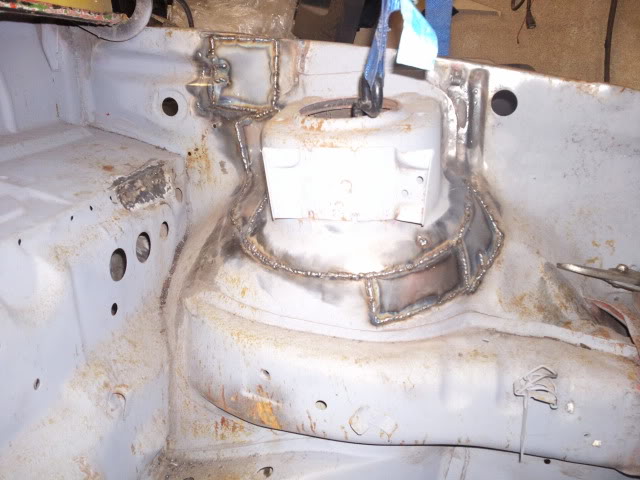

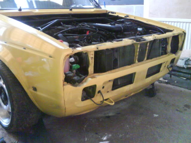

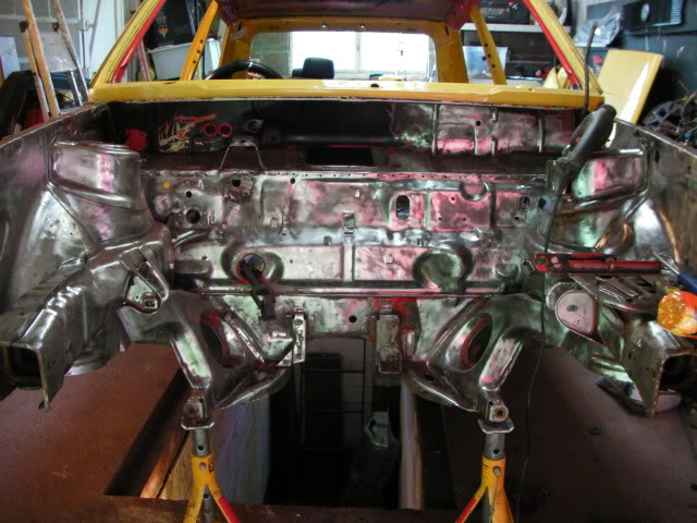

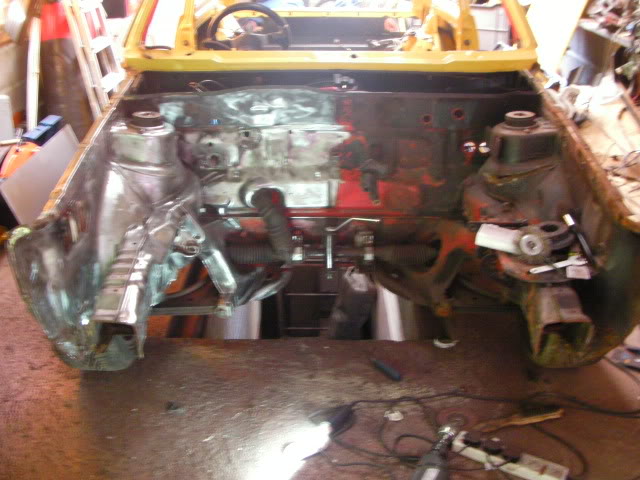

Right now all this was removed it was time to start finding what was solid and what was not so out came the grinder and drill and a whole load of wire wheels and brushes,I did remove the front pannel as this turned out to be rotten this did make access to the bay easier
after about a 4hours 10 smokes and a lot of arm shaking and resting this is what i had
another 4 hours

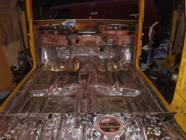

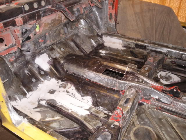

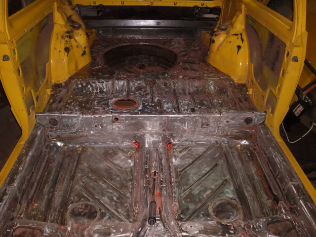

next was too strip the inside back to metal

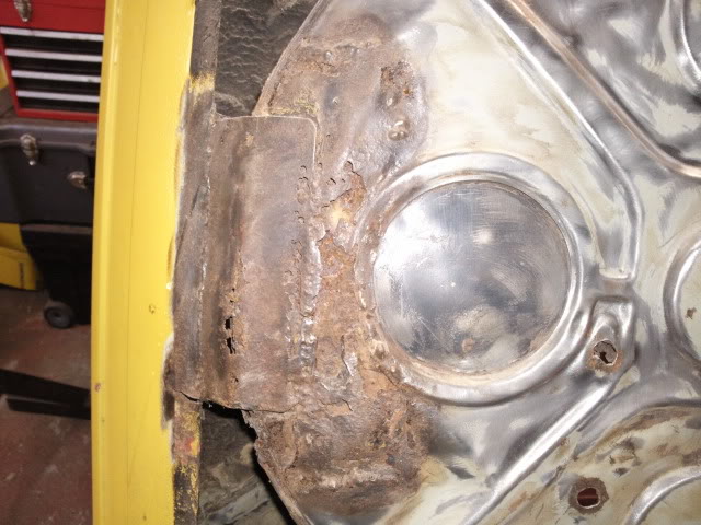

that done which luckily wasnt too bad just a few areas that need sorting main one being the drivers side floor pan and inner sill

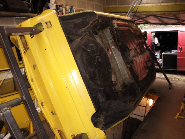

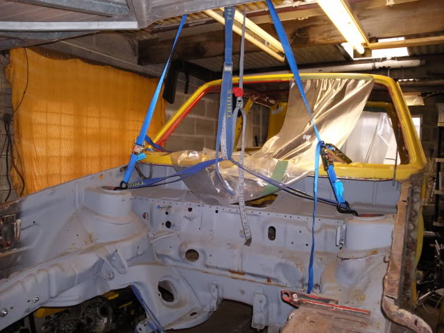

ok so i was happy for now, i made a jig/spitt up as you may have noticed which makes life so much easier i again lifted the shell on my own on to it which was no easy feat had to to use ratchet strapps and brute strength which almost dislocated my shoulder at one point when one of the straps slipped but determination is the key.

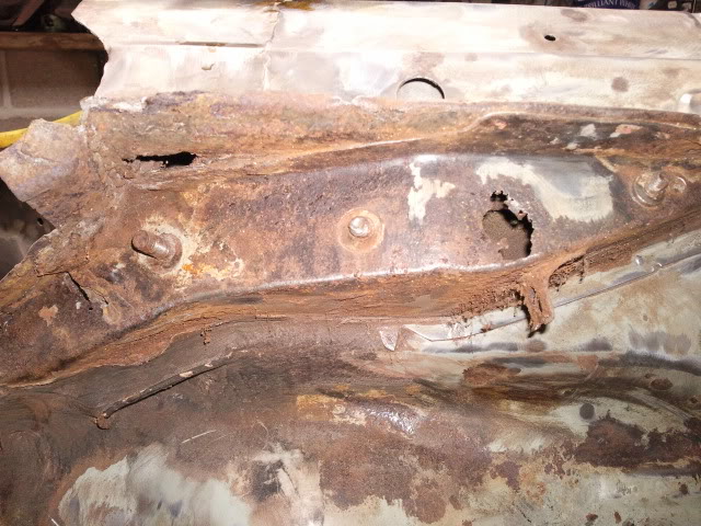

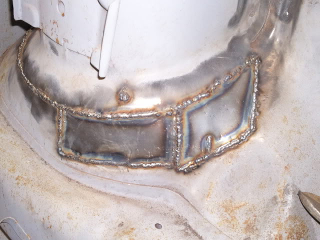

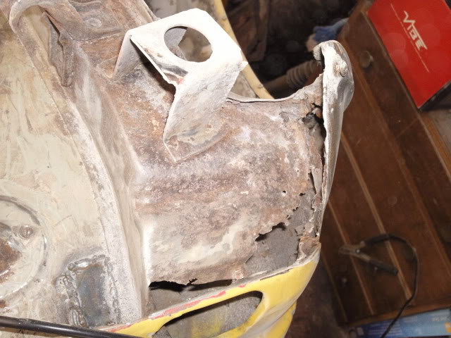

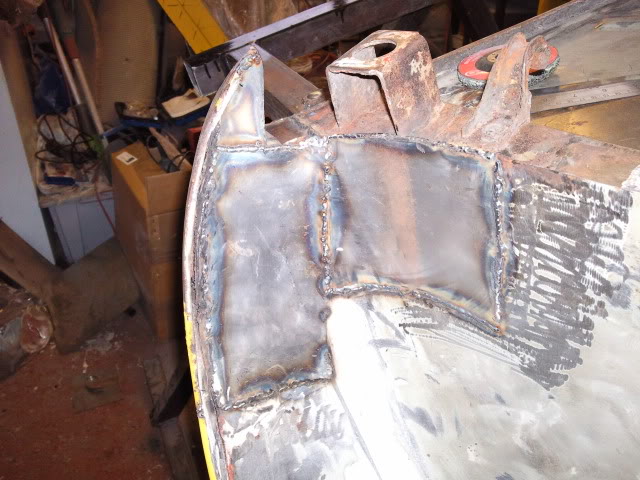

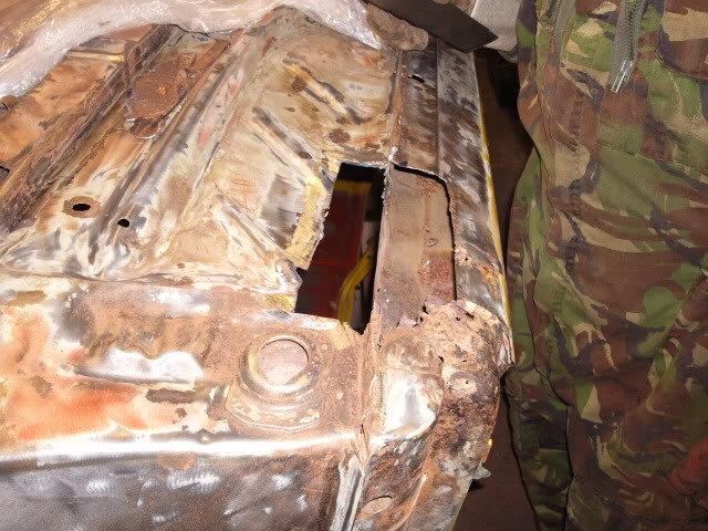

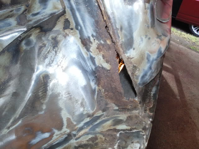

ok at this point i ran over my camer and lost a load of photos, but basically the bottom was completly stripped to reveal a world of hurt, almost to the point where i almost gave up on it, but i changed my mind and cracked on cut out a lot of rot and did what i could
to put right , there was a few parts that i had to get a mate from work to come and weld as one part was the rear chassi mounting point and there was no waywas i was going to attempt such a vital part with my, tomy my first welder.

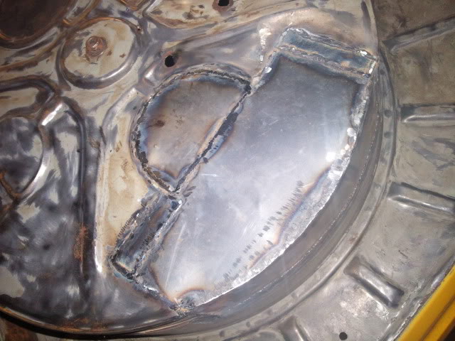

all the holes and cut outs have all been seal up now and all sorted

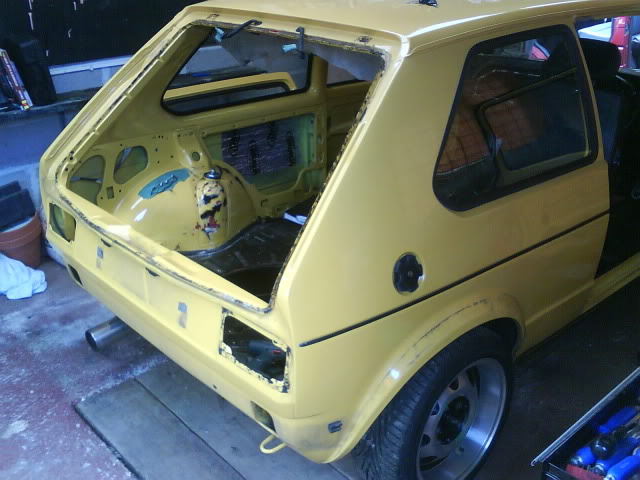

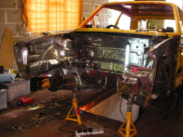

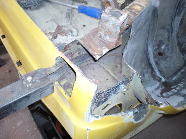

next stage was the rear end which was a messonce chopped of the bottom of the rear panneli could get to where i need
and it was pretty much the same story on the other side. Ok more to come in a day or two

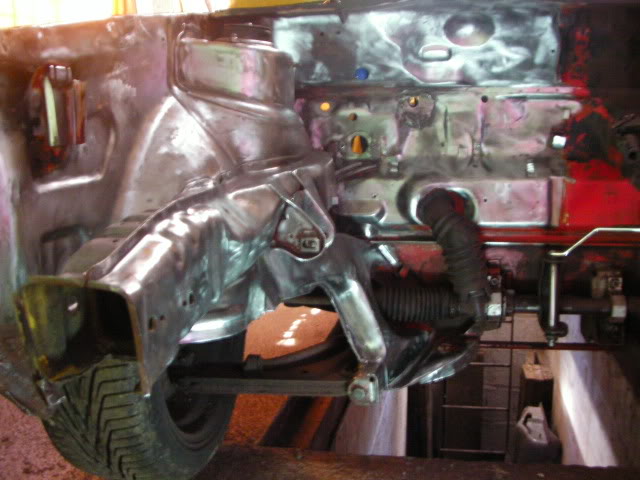

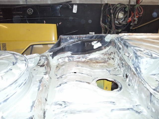

now it was just a case of tidying up bits and bobs before the the layer of mastic 121 was applied basically went round parts of the car and grinded and rubbed down then filled and one final rub down.

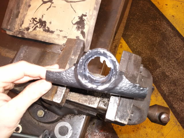

just quick one dont use hammerite metal paint for anything on a car especilly the underside or inner wings as i had the missfortune to find out the hard way, basically was in a rush to get the bottom done and without researching first thought this might have been an easy soloution, heres a pic of it hammerited.
looks ok untill i put stone chip guard on it and it reacted badly, i had to strip the whole bottom again not a happy bunny. Fortunatly with a grider and wire wheel it only took a couple of hours

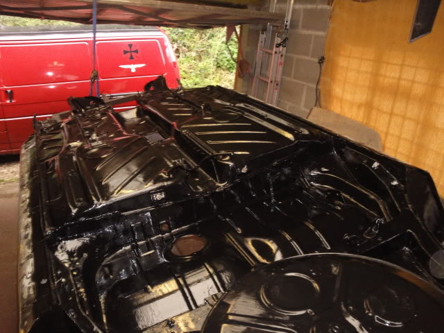

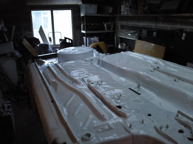

once that was done time to paint. The floor has now been sandwhiched between mastic 121 so touch wood should be good for another 10 years plus.

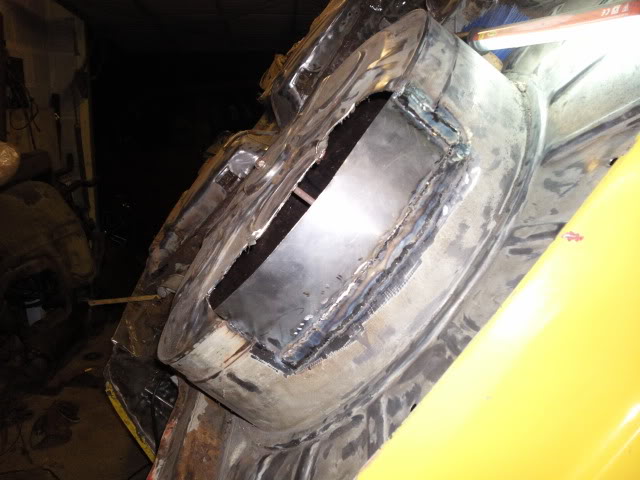

also welded back in the rain tray scuttle thing and seamsealed it. took the pic before seamsealer which has now plugged all the old holes. What is it actually called?

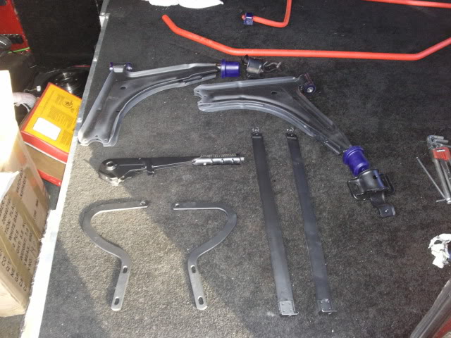

also cleaned up bonnet hinges tank straps wisbones, with new superflex bushes, did anti roll bars and brackets that fix everything in position
basically anything that was on the floor got picked up, cleaned and sprayed, all done by rattle can but with stone chip paint brilliant stuff.

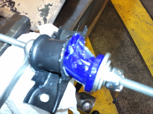

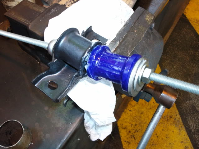

with nothing left to do i decided to fit my bushes. Now i have read loads about how to fit these everything from hitting them hard with a hammer to presses, and all thode that have wrote about this have said what a pain in the arse it was, however it took me 10 minutes from start to finish and that was getting everything out and putting it away, this is how i did it
first make sure you have grease a threaded bar, nuts to fit bar annd some washers as in pic and 2 spanners
right grease the bush
next insert bar through bush and bracket, add washers and nut on to the bar, the washers closest to the bracket need to be larger than the hole itself, now start to tighten up nut untill the bush is firm up against the bracket
now what you want to do is push one side of the bush in to the bracket and just tighten up the nut on one side the bushe will disstort a tad but it will slide through and pop out through the other side.
and pop there she goes
you dont need a vice you can do this stood up easy as.
