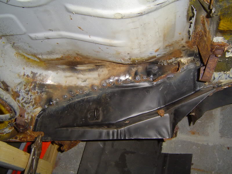

my 1st job is both rear chassislegs/axle mounts, only 1 is really bad but im doing both due to the fact im planning keeping this car.
drivers side partially cut back rot
passenger side
rear panel cut 2 years ago oops.
spent a whole day cutting back chassis leg and drilling out snapped stud ,inner sill is good so drilled spot welds and spent some time cutting new hadrian panel to fit properly, once happy i tack welded chassis in place untill i get my pub bottle refilled

the actual axle mount is 6mm guage steel box and the chassis leg repair is a cover over this really, once you clean all the thin metal away from the mount you can't really go wrong. If you look at top picture you can see i have started cutting away rotten metal and the axle mount is visible. if the axle mount was loose or rotten i think i would give up.lol. i am doing the passenger side this week so i will take extra photos for you if you like.cheers

the 6mm (ish) guage axle mount, this is fixed to body and is usually solid
drilled out spot welds of original chassis leg
i have decided to seam weld the upper part of the new chassis leg, but spot weld inner and outer sills to new chassis leg where it is visible.
i have to drill out the broken stud and clean up area ready for new leg, then trim new leg untill i am happy with fit then weld.

once happy i marked the area and cut out, and spot welded
then flushed and minimal filler
