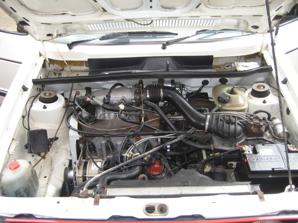

She started on the button and ran like a peach, from the test drive I knew I had to have her! I was going from a 2001 BMW 330ci which had every gadget you could get, so it had to be mint or the Mrs would have said no! Anyway we fell in love with the car, and bought it. We then drove her 165 miles home from Taunton. (Which I must admit was a little daunting at first, but she never skipped a beat. Anyway we continued to love her for about two and a half years of really happy motoring, she never failed to put a smile on either one of our faces. Here she was when I brought her…
As you can see, she was a nice example, not perfect in anyway but very nice. The amount of people that offered to buy it on the petrol forecourts said for itself.
During her time on the road I did a bit of tinkering here and there; fitted poly bushes throughout (too harsh for Telford roads!), Gaz coilovers, new wishbones, strutbraces, full Magnex exhaust + manifold and all the usual servicing, including a cambelt change.
All of this was new(ish) to me, as before I was 'a take it to a garage' kind of guy. My dad was a mechanic and a top class panel beater, welder and restorer of Truimph Stags amongst other classics…but whilst he was alive I never really showed much interest in the mechanical side of things; I was more into the finished product, not the blood, sweat and tears that goes into it!
