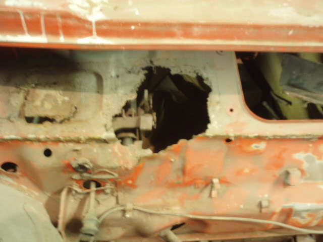

found some rot in the strangest places

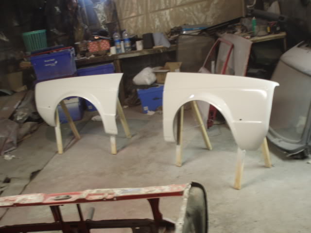

front wing got a good seeing to then zinked in all the right places
then primed ready for a good wet flat then primed again to get FLAT
spent 5 hrs doin the underside of the bonnet theN ZINKED IT
