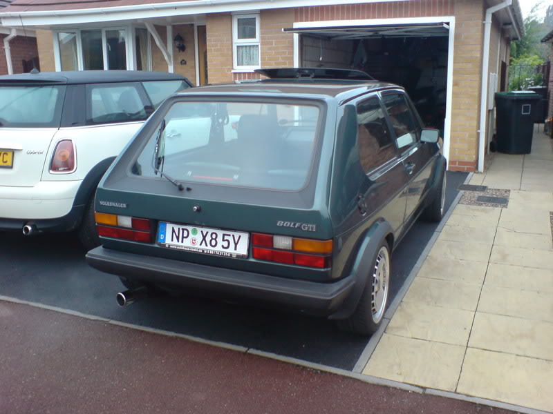

I got my self some Compomotives for a good price, went tp pick them up all was fine and dandy, they were et25 so should fit and clear the brakes…..nope. the et is thanks to the spokes being in the middle not near the edge and having a big spacer built into the hub, so this gave me issues. the caliper now touched the back of the spokes. so with a 5mm spacer they clearerd……..just, (this will get better as the pads wear down) they were now only catching on the top of the caper touching the rim..
Im still not sure i out of the woods yet though as the tyres have 50 profile side walls not 45s so I think they maybe too tall, but we will see when it back on the road, plus the wheels are an extra 8mm further out too..
on other news I tried pressing the brake pedal today, and its soooo short, these brakes should be brill with the new master cylinder and bigger calipers 8)

Yeah big brakes!!!! and clearance!
what you all think?
Daily - 05 plate B6 A4 Avant S Line, with 19s for the summer.. wifes car - Rare Seat Exeo ST Sport 170 Tech
Weekend - MK2 20vt monster - Plus a mk1 caddy I am fixing for my bro
but you've got away with it :wink:
tempted to find a back box that's shorter?
Looking good though 8)
