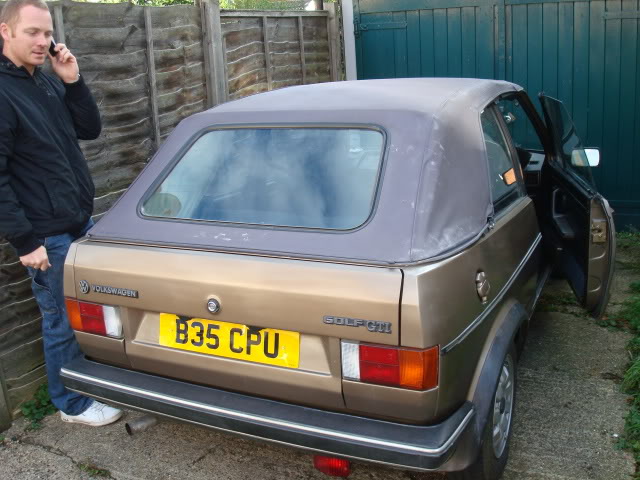

Good points are the bodywork is not completely falling off it, there is 11 months MOT on it and it runs, turns and stops. The worst things are the paintwork, it looks like it was painted by someone using rattle cans on a windy day whilst drunk and wearing sunglasses 8)

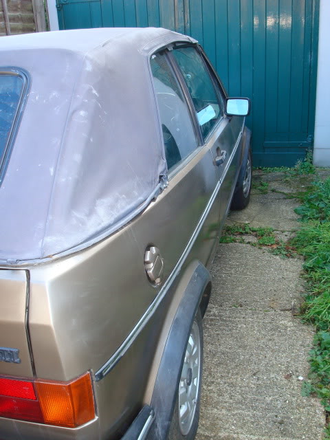

The only bit of rust we found
and the top needs replacing.

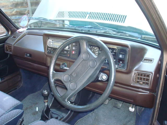

Inside seems pretty tidy and can be saved for now.
I'm loving the brown plastic dash, but not the misfitting CD player.

I am on the look out for a new hood now, thinking of going beige but can't seem to find a supplier, or should I just go to a hood fitter?

welcome aboard, the hoods are straight forward to do, but consider the interliner and padding that sits between the top and headliner at the same time, as you cannot retrospectively fit the headliner or interliner afterwards without undoing all your hard work.
You could consider camel colour as opposed to beige.
However I have a plan, I potentionally know where there may be a fairly new Beige one that I may be changing over for someone, so if it's going spare and we get it off okay, I think there could be a deal for you. I know it's history so it's reasonably new.
I wouldn't normally reccomend Secondhand as you don't know how old it is or the history. The last thing you would want to get is a porous roof that lets the water in, ending up getting a new one anyway.
I did sell a chocolate coloured one to a member on here, but he is selling his project car and the new hood with it.
It's Pinpoint vynil so it's correct grain for your year too.

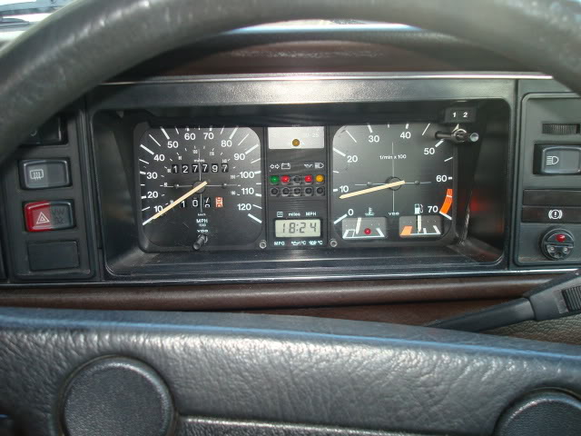

Gauges
Anyone got any information on the gauges - brand (vdo?) and do they ever come up?
My speedo pod also has the MPG module on it at the top, but doesn't appear to work. The computer is fine at the bottom, are the two linked or is there a separate sender for this?

The guages would have been made by VDO, they come up all the time on ebay and the like. (were also fitted to Audi coupes/80s so there are loads on the market!).
1987 Caddy 1.6Turbo Diesel-GTD
Instagram: Cavscp
Instagram: Cavscp
cavs said
there should be an airline that runs from the speedo cluster to the engine bay for the MPG guage-check or replace this before changing the cluster as this is a common fault.
The guages would have been made by VDO, they come up all the time on ebay and the like. (were also fitted to Audi coupes/80s so there are loads on the market!).![]()
Thanks for the help.

What is the switch top right of the cluster with the arrow marked 1 2 for?
