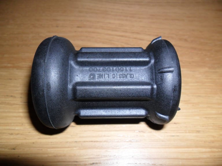

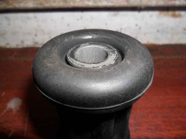

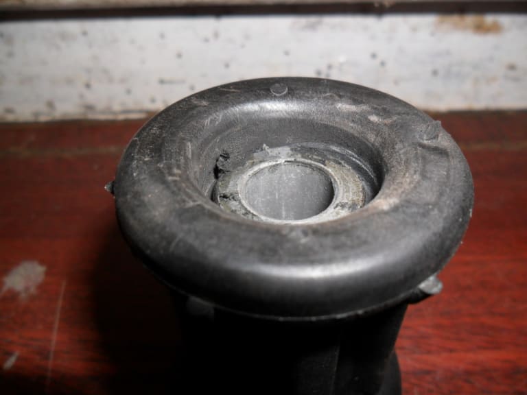

I thought they were symetrical - BUT they are not as the photos show.
Which way round do the bushes fit as they are not symmetrical???????
The bush has a "fatter" end (left of photo) and "thinner" end (right of photo) where the inner metal tube is more recessed.
Help greatly appreciated!
However, looking at your photo, I suggest the orientation you have got is correct.
Though you feed the bush in from the left hand side thinner end first in your bottom photo. So when fitted, the fatter rubber is in the larger metal and the thinner rubber is in the smaller metal.

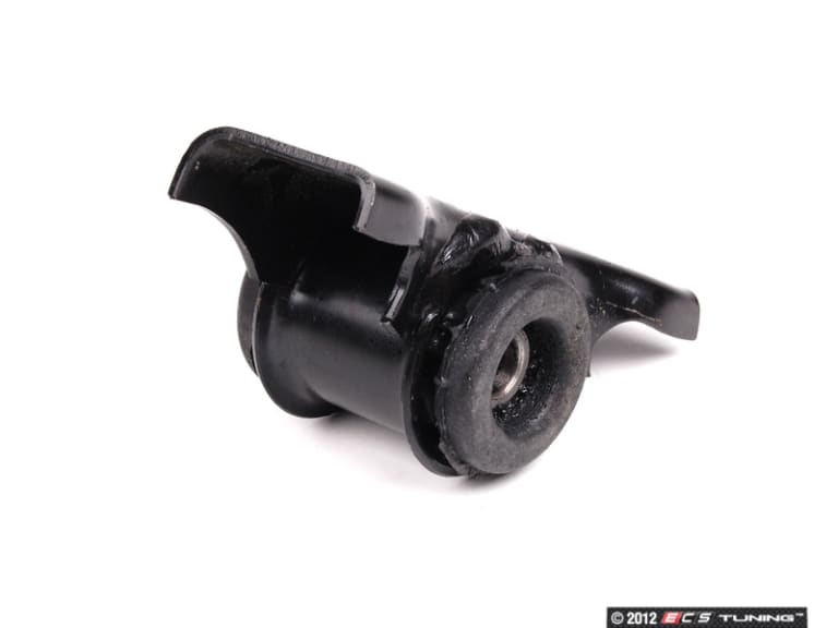

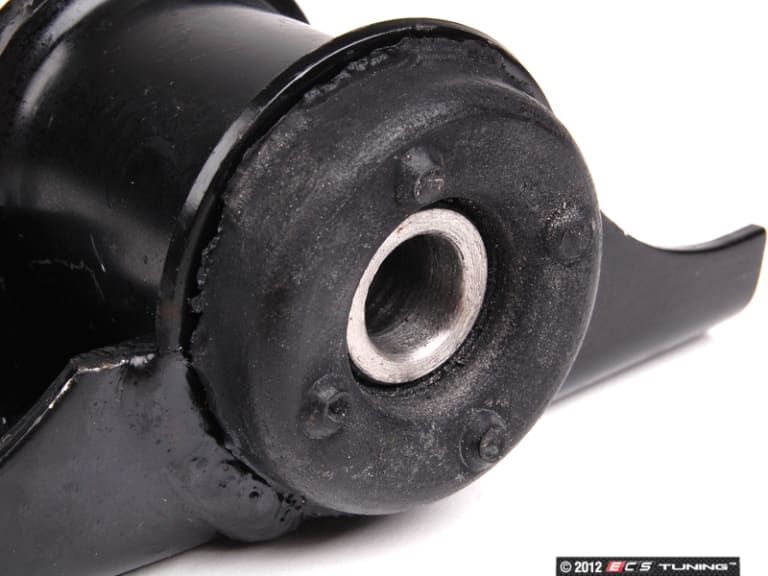

I searched the internet for the part number of the complete rear axle bearing: 171501537B and found these images. Clearly the fatter end with the recessed metal tube is on the outside.
