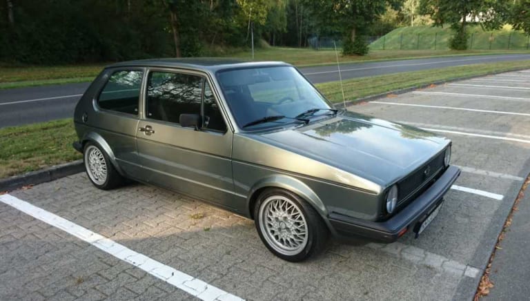

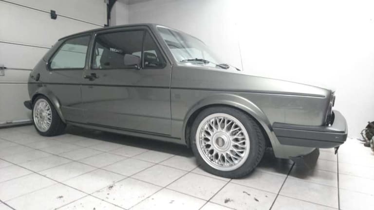

Post up sizes, specs, suspension, spacers, etc for reference
I'm running D2 36way adjustable coilovers, spun all the way down, ~100mm. The right front has been C-notched for driveshaft clearance.
I have a set of RH toplines, 7x15 et38 I'll post later. Also have a set of Artec 7x15 but don't have tires installed… on with the show.
BBS RZ 6x15 et45, 5mm spacer in front, 10mm spacer in back. 185/45 Nankangs
