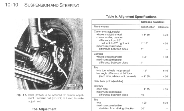

If you didn't scratch a line on the Strut to the Spindle, then you could be too far out either way to make the adjustment…. But if you loosen both bolts you can push the strut in or out, tighten while holding then look at the dial and "fine" tune it.

Camber is controlled by the 2 bolts that connect the strut to the Spindle, and the upper bolt has the Eccentrics on Both sides. You have to loosen both bolts to set the camber. Since the numbers didn't change from the before to after, then they aren't setting it.

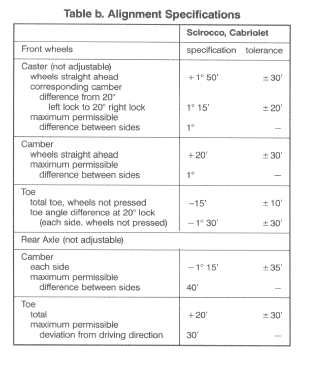

The left and right camber was't adjusted at all and needs to be adjusted for the camber as if you look at the pictures next to it it tells them which way to set it. I have had alignment guys show me it isn't adjustable on thier machines, and that I would have to live with it,,,(which is true for Caster (well replacement of parts)) but Camber is set by the bolts and when I point that out…as they have adjusters they go whoopsie and can effect the toe of the car as well…. if really out you notice a really good cornering..to one side
So you can take this with you….
