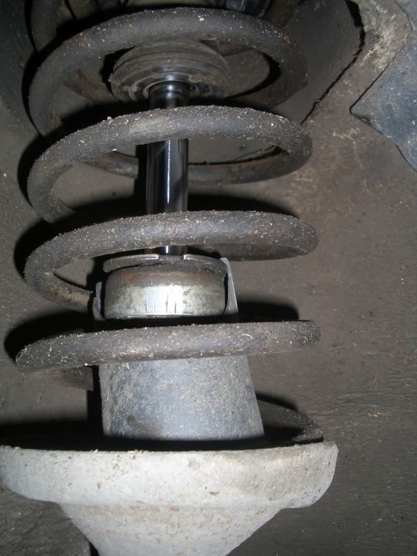

The bump stop caps do they go down first then the bump stops or are the caps ment to go over then bump stops, just because on my one the bump stops are visible and the cap is at the bottom of the spring, sorry if I'm making this confusing just need a little help making sure it bes done  right
You need to buy spring compressers to do this job as you have to remove the spring 20ish £ should buy you some.

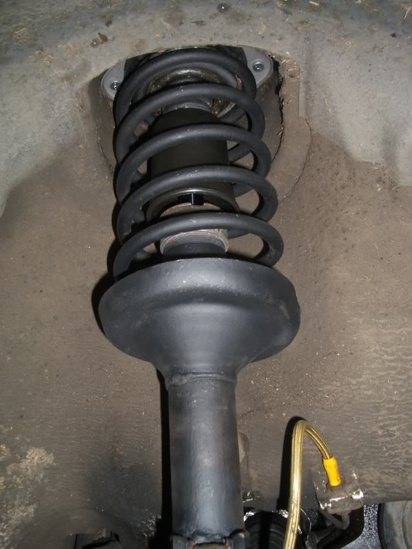

If the plastic dust cover is at the bottom of the shock it's either broken of come lose from the bump stop.
They should look like this when the car is rasied.
If they look like this then either they have come out of the grove in the bump stop or the bump stop is broken into bits.

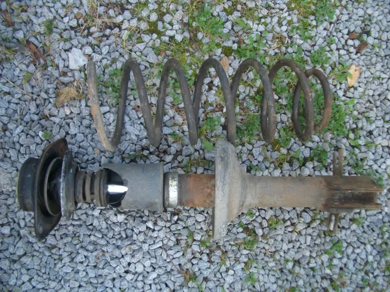

You can see the grove in the bump stop in this picture. Mine broke because the shock was worn out so need replacing.
Follow the guide in the other link to remove the front strut and check the shock while its all off the car and the spring has been removed, fit a new set of top mounts if the top metal bit has started to move up from the rubber, its where the nut at the top is.  You will also need to get the camber checked once everything is back on the car.
Thanks mark1gls, mine has come lose, thanks again guys appreciate all the help  :thumbs:
