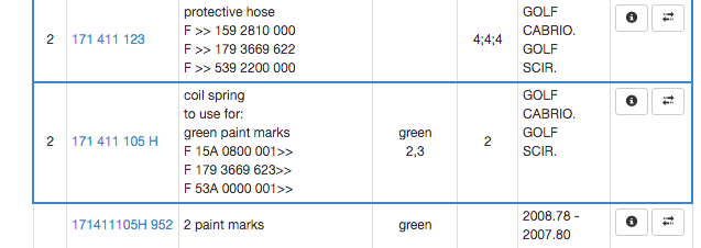

My '83 GTi Campaign has lowering springs fitted, and want to restore it to standard springs.As you know - all the main new parts suppliers sell a "one spring fits all" - clearly not suitable for the GTi.I am trying to wade through the minefield of VW paint marks............ Looking at the parts list 53511105A looks like the correct item
22 | 531511105A | coil spring; GOLF GTI; | 2 |
531511105A 952 | 2 paint marks; to use for:; yellow paint marks; yellow; 2; RABBIT GTI;; SCIR. | ||
531511105A 953 | 3 paint marks; to use for:; yellow paint marks; yellow; 3 |
171411105G 951 | 1 paint mark; to use for:; blue paint marks; blue; 1,2; GOLF GTI | |
171411105G 953 | 3 paint marks; blue |
They have the correct tapered wire as well.
The company will just supply the springs if thats all you need.

When I was doing my research back then I did talk to a company who was in the process of remanufacturing GTI spec springs - I'd have to dig around to find out who as can't recall off the top of my head!
I recently bought some allegedly standard springs made by Lesjöfors from autodoc.co.uk, £23 each, Part Number #4095007, which they claim is equilant to 171411105G. The box says "Coil Spring Front VW Golf 1.6-1.8GTI/ CABR / SCIROCCO GTI" so I'm hopeful that they are the correct part.Haven't fitted them yet.
pdr10 said
old thread I know, but…
Let us know the results.
I know that my fronts are 4 dots white white white orange/brown? From the etka.
Cabriolet (vert)
Rears:
Tintop
Front:
Rear

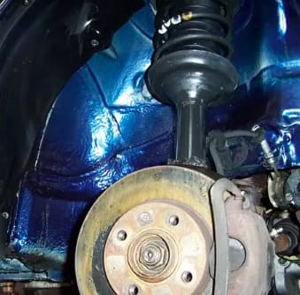

171 411 139 Underlay for coil spring (upper)
171 411 140 Underlay for coil spring (lower)
I think these are missing from the aftermarket struts on my car - do you know where I can buy them?
