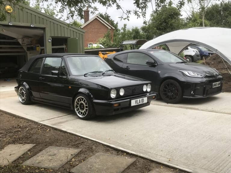

PFA. Dragged it out of the workshop yesterday and gave it a clean 👍
thanks
Kingy76 said
Can’t really help with your question as my cabby brakes are dire also so I’ve just got standard Brembo gear and just live by my wits most of the time but love your wheels that don’t look like the standard size snowflake wheels so please can you advise what they are as they look a good size and polished they look great?
thanks
They're 1552 Snowflakes, 8x15 (or maybe 7 can't remember) they only made a limited amount of them about 10 years ago so very rare now.
