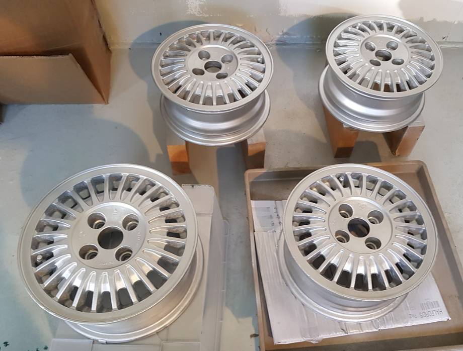

I recently purchased some original 13" scirocco storm alloy wheels to put on my 78 Scirocco GT.
The current steel wheels have 155R 13 79T fitted, but the wheels I bought don't have any tyres fitted.
Any ideas what tyres I should use on these wheels? (the same as the existing? Or something different?) Any preferred brands etc?
Here's a picture of the wheels after I painted them yesterday, hopefully they will be a great improvement to the look of the car
![:)](https://vwgolfmk1.org.uk/themes/default/images/ocf_emoticons/smile.png)
Part number for the wheels is: 311601025g
Thanks for any help
David

Assuming your wheels have something like 5,5JX13H2 ET38 stamped on them then a tyre size 175/70 x 13 would be appropriate.
I have 5.5J steel wheels fitted with 5,5JX13H2 ET38 tyres on my Mk1 Golf.
Please check that number 5,5JX13H2 ET38 is stamped on your wheels. If there is a 14 instead of a 13, it's a different ball game.

175/70R13 | 5.5Jx13 ET42 | 4x100 |
https://www.ebay.co.uk/itm/VW-Scirocco-Mk1-Storm-Alloy-Wheel-5-5x13-321601025G-EB-341-/371959521662 looks the same?
http://www.sciroccoregister.co.uk/dr-dubs-scirocco-storm-site/scirocco-road-wheels/

So i suppose 170/70 x 13?

rabbitson said
Indeed, stamped.on the side is 5.5j x 13H2
Looks that way. You could go thinner.. but that's not the oem size then.. 170 /60/13

That's the size fitted to my 13 by 5.5 wheels on my Mk1 Scirocco.
