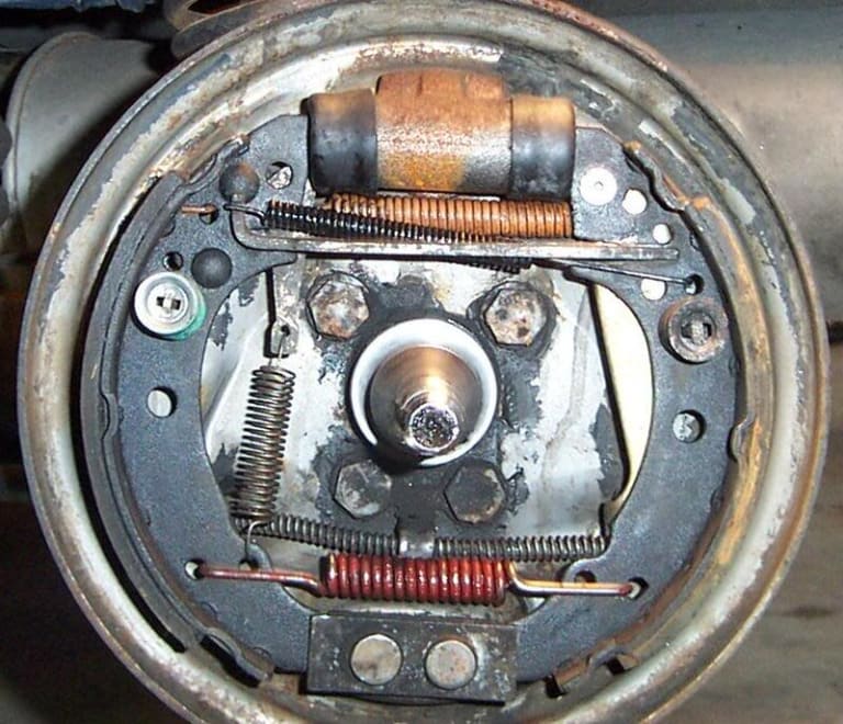

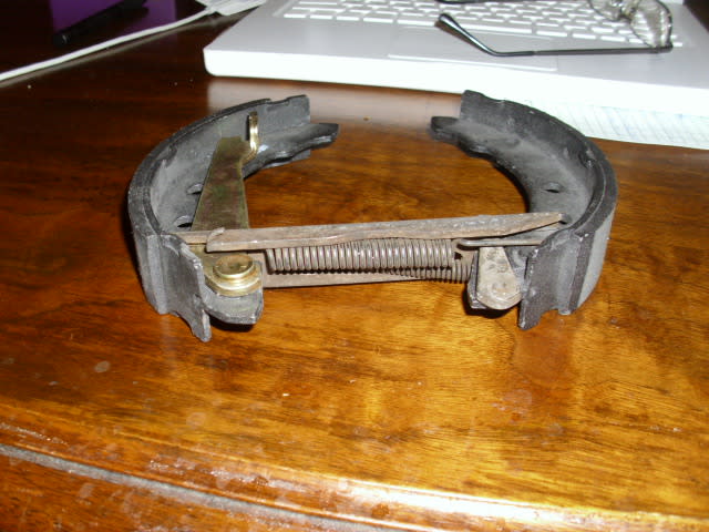

Pull off the drums and look-see before starting to twiddle and disturbing other stuff
the spring on the adjuster wedge is broken, or missing the wedge or the wedge was put in backwards and can't adjust.
Taking it apart and inspection is warranted.

But I have seen over the years of ownership where the POS (previous owners Service) have placed in in the assembly incorrectly.
Some Reference Pictures for you.
