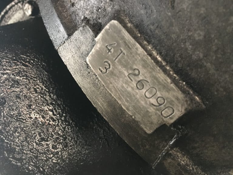

There is the gearbox number but confuse in which drive I need and where to purchess one in uk

Red 15 tooth.
171.957.821.B
https://www.vwheritage.com/171957821b-speedometer-drive-gear-z15-for-manual-gearbox-red-vw-spare
Don't forget the clip. The ETKA isn't working today….so I can't give you the part number.

Clip?? Sorry I don't have clip as the drive itself is missing

There is a Small "C-Clip" that holds the gear to the cable. in removing the cable I have heard of the clip failing and the gear falls into the tranny…..
errr… have to agree that a 'missing' drive is prob in the gearbox from someone yanking the cable. On my GTI the deep pressed metal 'paint tin lid' was very tight and I had to carefully lever it with 1st a razor blade and then small screw drivers. Pulling the cable would have just stripped the clip and drive off the cable leaving the pressed metal cover fixed in the gearbox and the bits dropping into the bowels of the gearboxBriano1234 said
