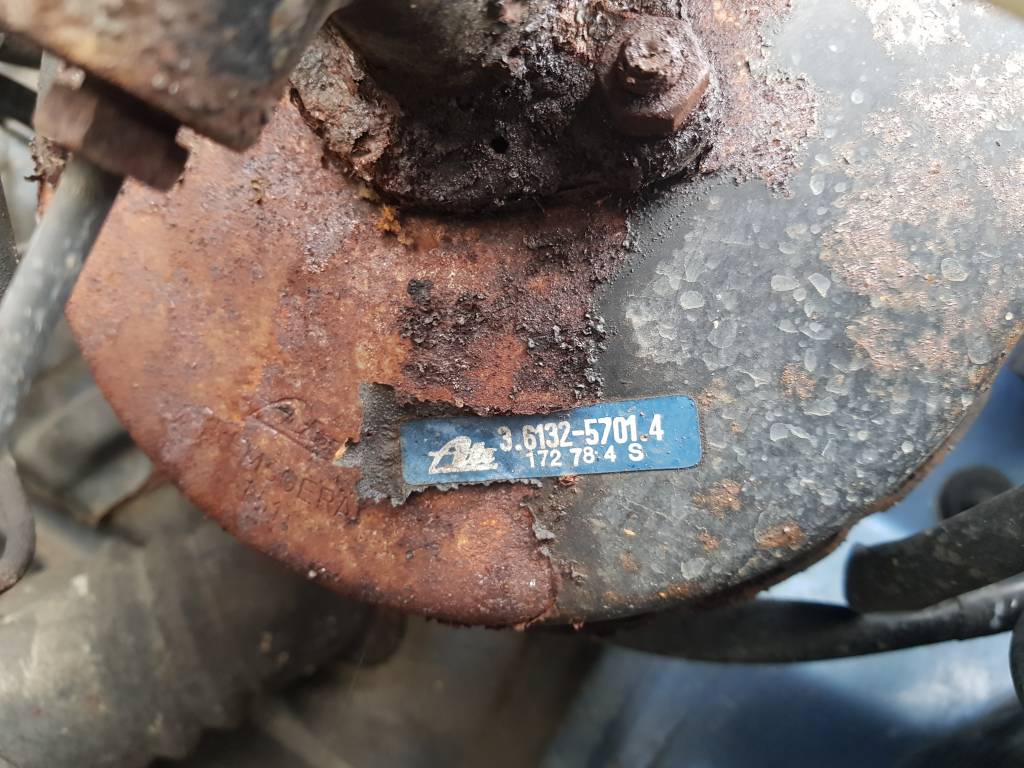

I had a look at it and I found this printed on the servo:
I suppose that is the oem part for my 78 Scirocco, I had a look around for a replacement using the part number 172 78 4 S but nothing appeared, so I am wondering what that brand name is? (maybe that can help my search)

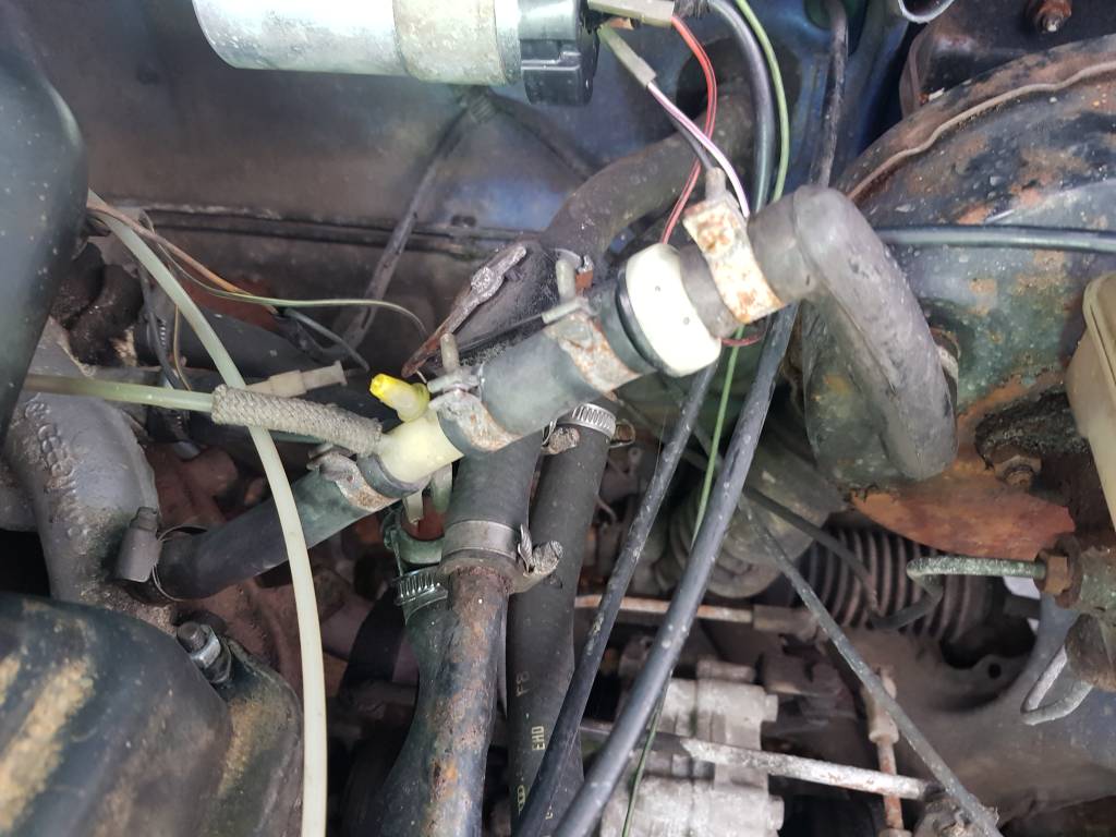

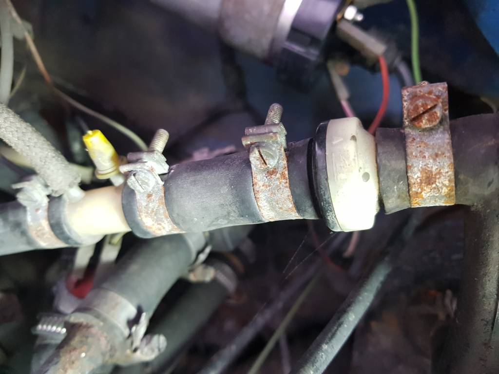

Make sure that your vacuum pipe isn't cracked or holed and that you don't have a issue on the grommet that the check valve goes in to the servo…. could be a simple fix, as when my Diesel Vacuum pump broke taking out the vacuum to the booster…
The pipework looks together, I can't see the grommit you refer to?
There is a kind of daisy chain of parts on that pipe, all of which might leak on that hose, maybe I should get a new pipe and clamp it all with new clamps, but what are those other plastic parts? could they also be causing an issue?

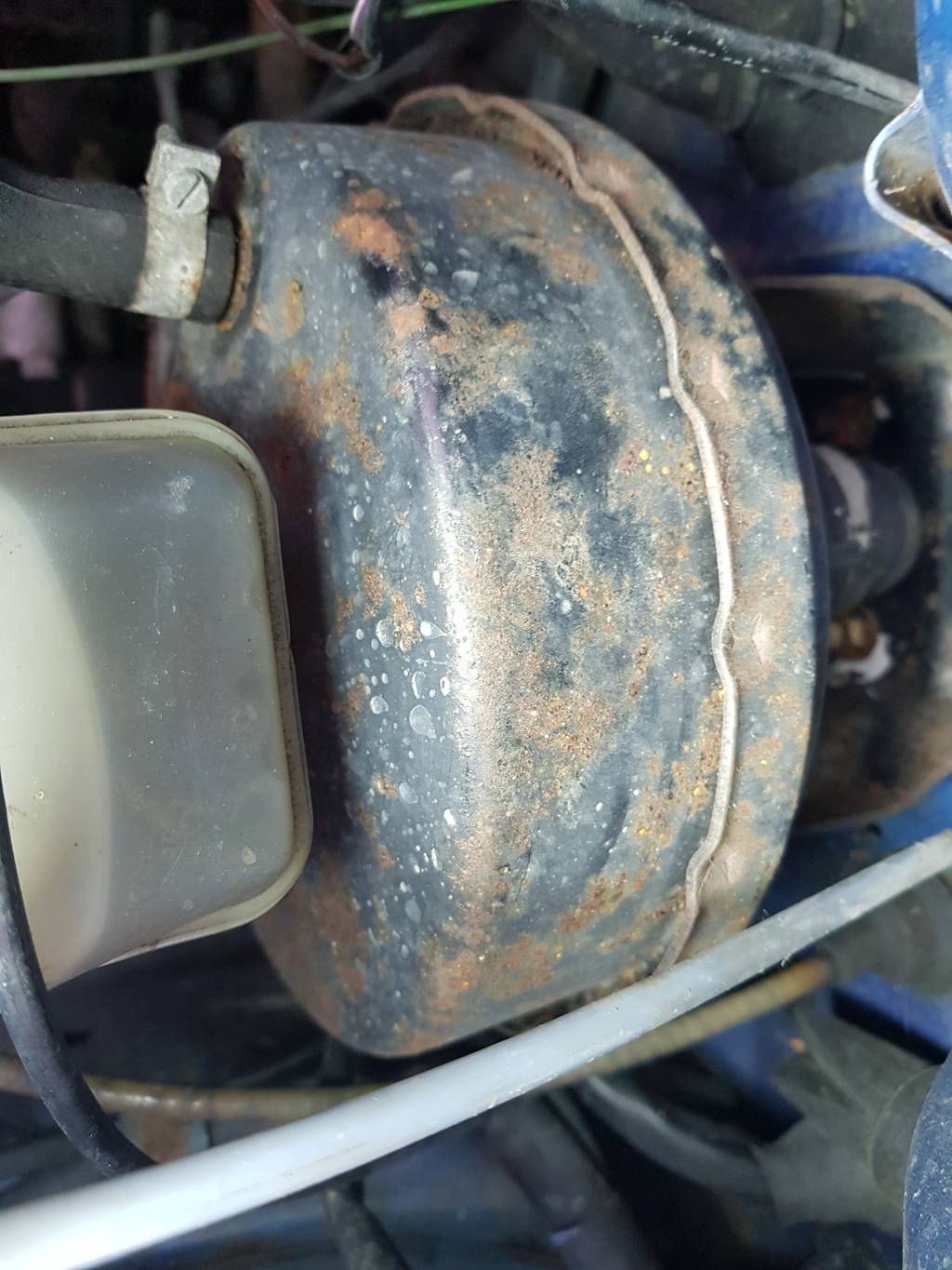

My current thinking is that the servo has corroded through and so needs to be replaced, Ideally I would also replace the mc at the same time.

I am a little nervous as I still have not manage to find a replacement part for the servo part number shown in the last photo (172 78 4 S) and I am not really sure where to look next.

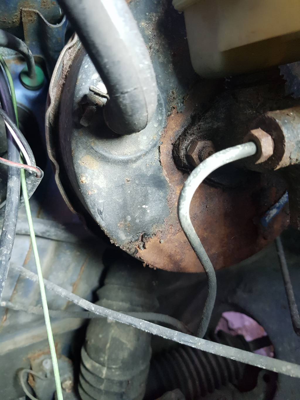

here are some more images for general info, in case it speaks to anyone here:
