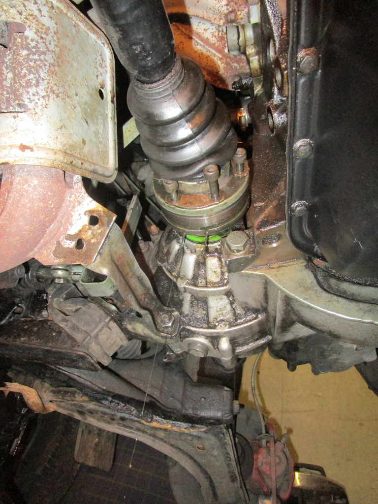

You will need to make a tool to stop the flanges flying off when removing and to keep them on when putting it all back together.
The hardest part of the job is getting the circlip back on as it has a tendency to keep flying off the circlip pliers.
It is possible to change them with the gearbox on the car as there's just about enough room.
I've changed seals 3 times, twice with the gearbox on the car and once with it off, much easier this way.
My home made tool, 3 threaded bars, some nuts and a alloy cross bar, you don't really need the box section which I have.
Time I did it with the gearbox on the car.
Leave the green seal in place.
New seal fitted.
Make sure you used the right tool to undo the drive shaft bolts, 12 point spline tool is needed.
I found I had to loosen the camber bolts to get the drive shaft out of the way or perhaps undo the bottom ball joint so you get enough movement to get the driveshaft out of the way.
