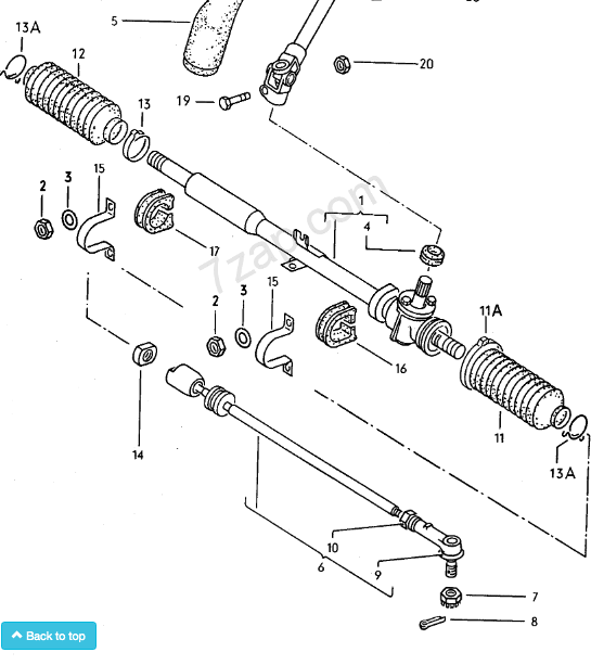

On some Cabriolets, and First edition Golfs/Rabbits and mk1 the like. They had a one-piece fixed Inner and outer Tie-rod on one side and a inner, and outer tie-rod on teh other.
Later on, The Cabriolets and or Golfs could be modified to have 2 2-piece units.
like this these are just pictures…..okay.
So you can go with separate inners, and outers for both sides and still get the car adjusted…. I find them easier as it is usually the outer that goes south.
I will strongly urge you going back to slather the outer threads of the inner rod, or grease the hades out of the inside outer so that in the future you will not have an issue with getting the lock nut, or the outer tracking rod loose.
For the Alignment or tracking specialist, they are way easier to adjust…. Specially if they are lubed.

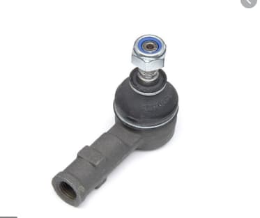

Will this fit bri
Thanks again not sure how it's fitted but will cross that when I get to get
https://www.ebay.co.uk/itm/283054138057
It should work just fine. Just needs the outer end.
Buy both outers at the same time from the same vendor so they are the same make….size length, and if you can still get the ones with the Zirc fitting for grease the more better.

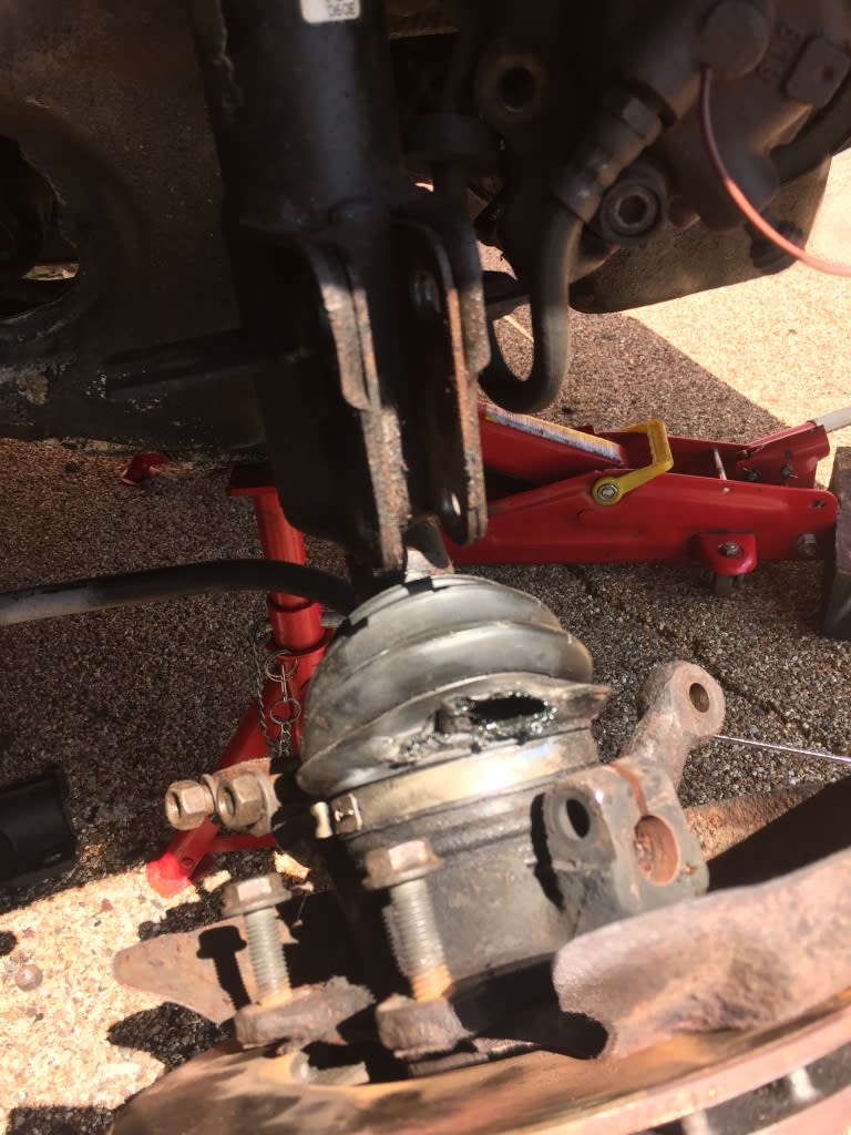

Today I had a few hours so tried to remove the ball joint, my newely tapered flat screw driver done the job but still it need lots of damn hard persuasion to be removed the other side was a piece of cake, when trying to remove the swing arm the large bolt would not come all the way out the gear box sump looks like it's in the way so yet again another issue.
I also damaged the outer cv boot so will need to remove that,
Any suggestions would be gratefully appreciated at this difficult time 😂😂😂
The lower Ball Joint I have found over the years to be a either or thing. Either it comes out easily, or…PITA.
But I have found that the use of proper force is the key, and I always tend to do this first.
Sorry no pictures.
Where the Pinch bolt holds the lower ball joint to the strut, after removing the bolt, I insert a screw driver in to the rear slot, and tap it twice with my 4oz Ball Peen hammer to open it a wee bit.
I have a Crow-bar Pry-bar that I place between the control arm and either the Lowest part of the strut housing, and or the Pinch Bolt clamp, and pry the thing down till it comes out On my Cabriolets I place it between the sway bar and the control arm so I can't damage anything. I have also increased my success with after the first time replacement of the lower ball, I clean the pinch point with a wire brush to get it shiny, then coat the clamp area, and the ball Joint with Never-seize or Copper Grease as you call it.
I make note of the position of the ball joint as the way it is pointing, and prior to re-inserting it I get it in the same general position.
I do know that on a Cabriolet with the outer sway bar clamp removed, so there isn't any tension on it that the ball joint usually separate nicely.. I also have a couple of suspension forks (pickle-forks over here) that I can get between the ball joint and the clamp and it prys out nicely, but destroys the boot of it. So It depends on what I am doing as in replacing the ball-joint or the Strut or CV as to where I pry, the Ball, or the Sway link. I use the Sway link when I am doing the CV or the Strut as the Ball joint needs to be re-used….I also re-coat never-seize on the things.
