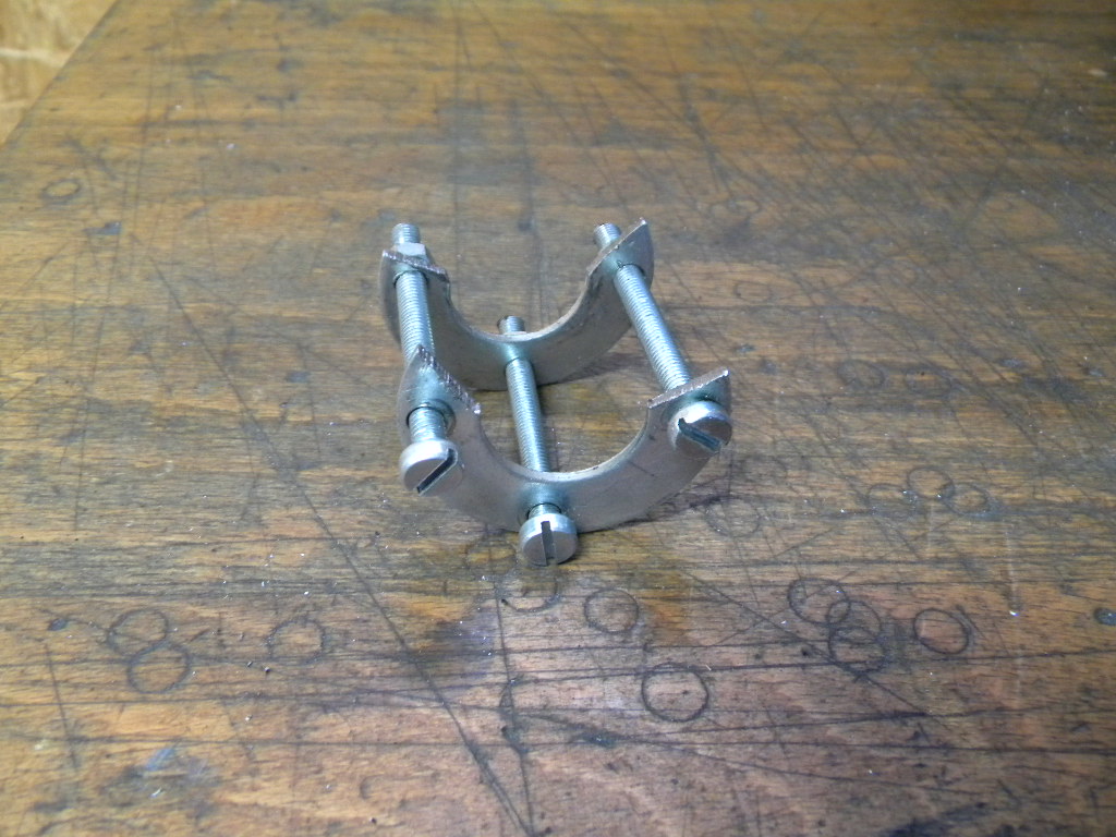

The essential complication is the pressure spring , it must be compressed to insert the column in the cardan ,
I made a small tool with two washers that i opened to be able to take them out at the end and three screws to tighten .
Be careful cause the spring is tared pretty strong , so be careful anyway ,
Use the mark at the bottom of the column (notch) to position correctly in the cardan ,then install the screw and the nut.
The spring compression tool wil be removed only after reassembled  the neiman block part , otherwise the column goes down and there is not enough thread to screw the nut of the steering wheel ,
