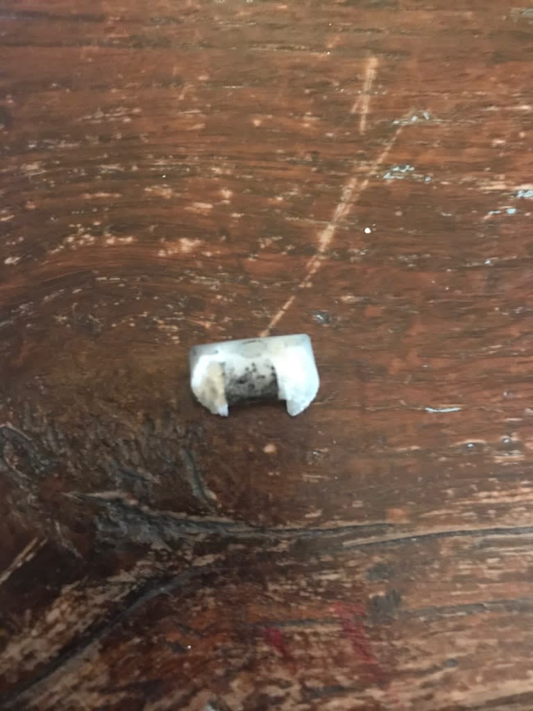

Haven't really looked where the break is but im pretty sure it has broken right at the pedal as i found this little sucker on the mat…
yeah thats the end of the cable snapped off at the pedal.

It had snapped right at the pedal.
Which i think is from me using a screwdriver to get it over the hook last time. Time will tell i suppose. Everything looked right up there.
Better than it rubbing somewhere or a sharp edge or whatever.
Anyway, seems all good!
Yes using a screw driver to get the plastic end on the pedal will not of helped, fit the cable to the pedal 1st then pull the cable at the gearbox end once you have the adjustment screwed all the way to the top then adjust the cable so you have 10mm free play at the pedal end.
