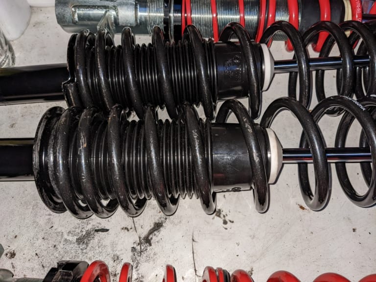

This was a setup I fitted years ago before changing to shorter bump stops and collapsing dust covers.
I’ve had a few different lowering kits over the last 20 years, the black spring in the picture is the original VW spring.
You can see what’s cut out say on the spring
mark1gls said
You can see in the is picture how much I had to cut of the original bump stop when lowering my car.
Nice, that looks about the same as I cut out! Collapsible dust covers sound a better option to go with a cut down bump stop, might have to look for some - is there a standard part number by any chance?

When 1st lowered my car about 15 years ago I used the standard length rubber bump stops and the car would crash and bang over any bump in the road and the plastic dust covers eventually smashed them selves to bits and that's when I noticed very little gap between the bump stop and the strut housing. I then started to cut the middle out of the bump stop as in my picture above.
When changing my suspension again the kit I brought had the shorter bump stops (the same as your link above) and they work well, you don't want them much shorter or the bottom of the car will hit the floor
