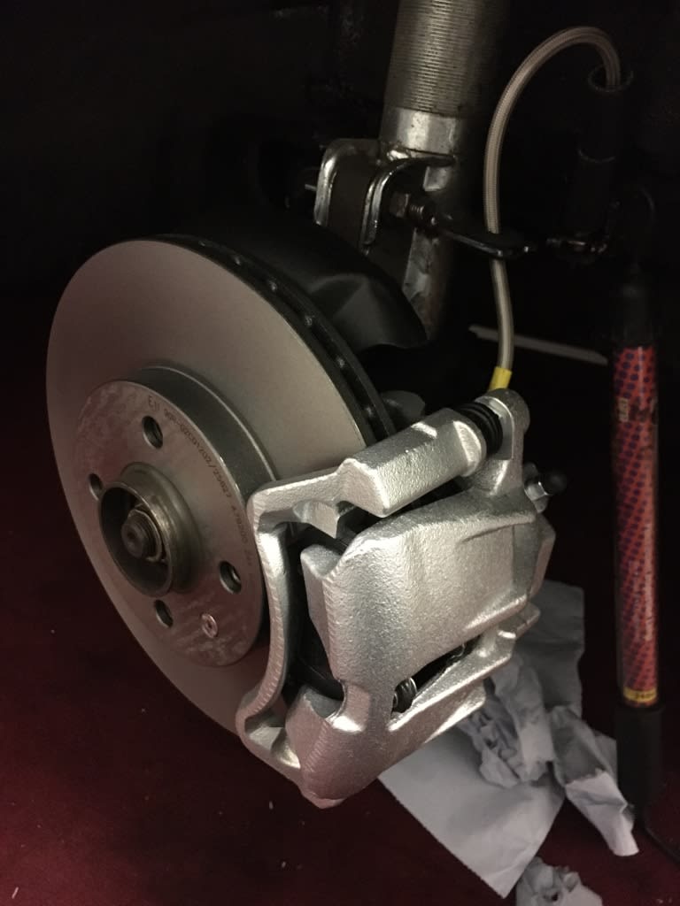

Problem = my current calipers have hub fixing separation at 85mm so the carriers I just bought will not fit.
Question = what brake upgrade will fit my hub?
Photo of my existing hub fixing;
Hence people fit scirocco carriers + 16v calipers.
The carrier fits onto the hub.
Then the caliper fits onto the carrier.
However, I think the scirocco carriers will not fit on my MK1 convertible hub because they have ~85mm separation on the fitting. The scirocco carriers have 75mm separation.

I thought the regular mk1 caliper is secured to the hub, there is no carrier. As far as I know.
they do use a carrirer bolted to the hub then
caliper attached to the carrier

The benefit is that you have the more efficient 54mm caliper with a larger braking area on the disc so car will stop quicker and lock up less.
By the way, as ABF said, OP is measuring the wrong part. Carrier to hub is 75mm.

I am not an engineer but the bigger ones give you more braking torque and dissipate heat more effectively. Therefore if you have been going through a few roundabouts in a spirited fashion the bigger brakes will stop you more consistently and efficiently. I have had the dreaded brake fade in some cars and the bigger brakes are definitely better in this regard. Would be interesting to see a comparison test on a real road test as you are probably right that the first few stops may be similar but once heat rises I would expect the bigger brakes to be better?
They also reduce the dust. I have been using Hawk Ceramic pads for years, and I haven't experienced brake fade at all on standard 90 Cabriolets brakes.
