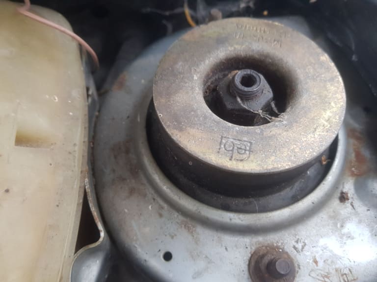

New top mounts look worse than the ones I took off!
I paid for Febi top mounts because I've had Chinese rubbish ones before and they never last. I ordered these from GSF and then due to being away and covid etc I didn't fit them until now because the MOT is coming up and they sat in the boot for 9 months.
When I opened the box I saw that the top mounts were not in Febi boxes and in fact were in two different boxes but I thought stuff it, I'll fit them anyway because the MOT is due. After fitting them and now the car back down and they look like this; these are trash aren't they?
They look worse than the old ones which were an advisory on the MOT but genuine Febi. Thoughts?

https://forums.vwvortex.com/showthread.php?9278079-Another-way-to-reinforce-Mk1-strut-mounts&highlight=strut+mount
Weld your studs.
Beefing up your Strut Mounts. | VW Vortex - Volkswagen Forum
https://forums.vwvortex.com/showthread.php?7133629-I-hate-my-strut-bearings!-Ideas-for-HD-replacement/page2&highlight=strut+mounts+urethane
The use of the opel o-ring is easier and a tad cheaper than filling with window weld, but if you do use the window weld, do it a week or 2 before putting them in.
So is this normal for brand new mounts?

There are ways to Beef them up.
Weld your studs.
If I could be ar5sed to take mine off, I'd do that mod with the exhaust hanger. Next time….
