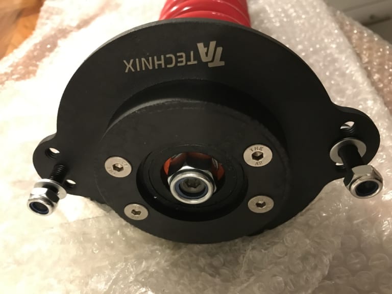

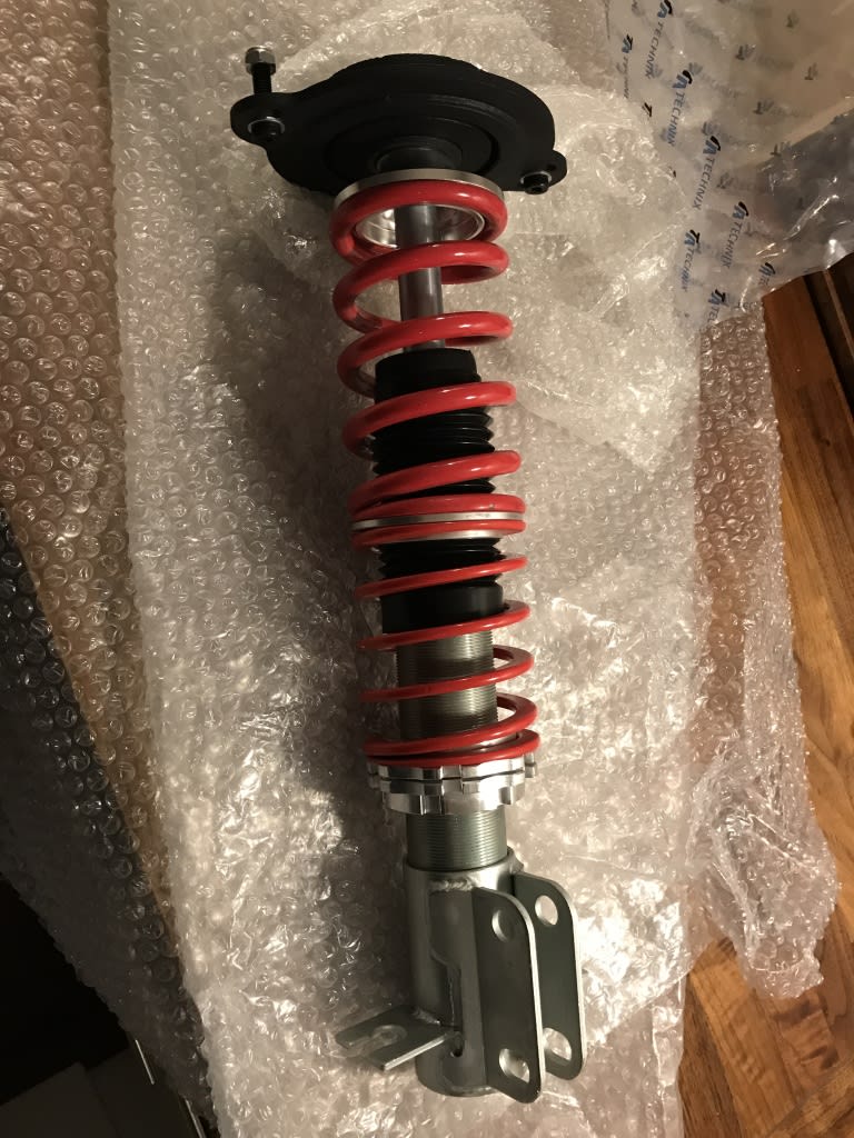

I recently bought TA-technix DEEP version, and it comes with camper adjustable top mounts, allthough you can buy versions that can do even more eg these
http://lowride.pl/?product=vw-golf-1-jetta-1-caddy-scirocco-i-ii-mk1-camber-plates-regulatory-katow
but these coilovers at least go so low you wont need higher topmounts.
