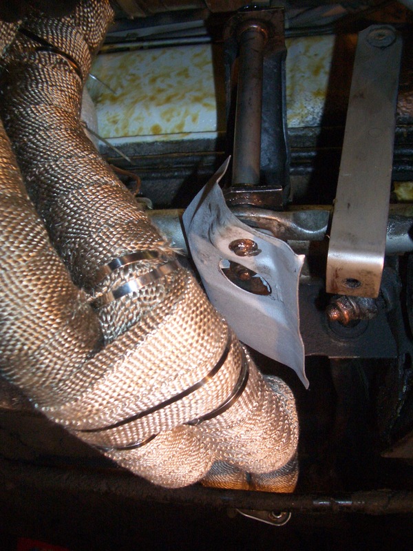

No 14 in this picture.
http://www.ebay.co.uk/itm/GEAR-SHIFT-SELECTOR-RODS-FOR-5-SPEED-GOLF-MK1-CADDY-SCIROCCO-JETTA-1-6-1-8-/361561349880?fits=Model%3AGolf&hash=item542ebc5ef8:g:MtsAAOSwd4tT3SDj
Should look like this.
http://www.ebay.co.uk/itm/VW-GOLF-JETTA-CADDY-SCIROCCO-MK1-1-6-1-8-GEARBOX-GEAR-LINKAGE-ROD-LEVER-BRACKET-/281991187208?hash=item41a7fc0b08:g:I~MAAOSwQgpXAWdo
Heat shield lives here.
