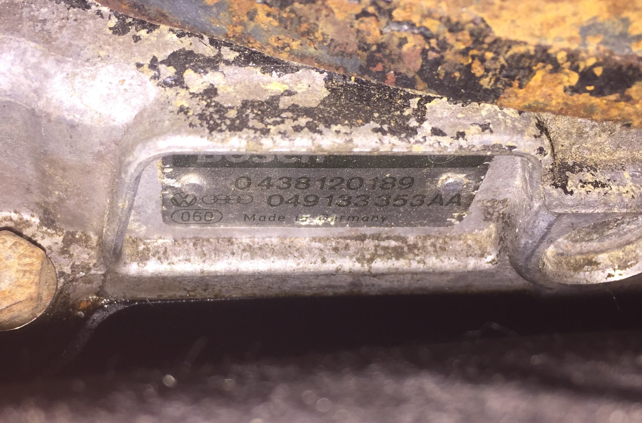

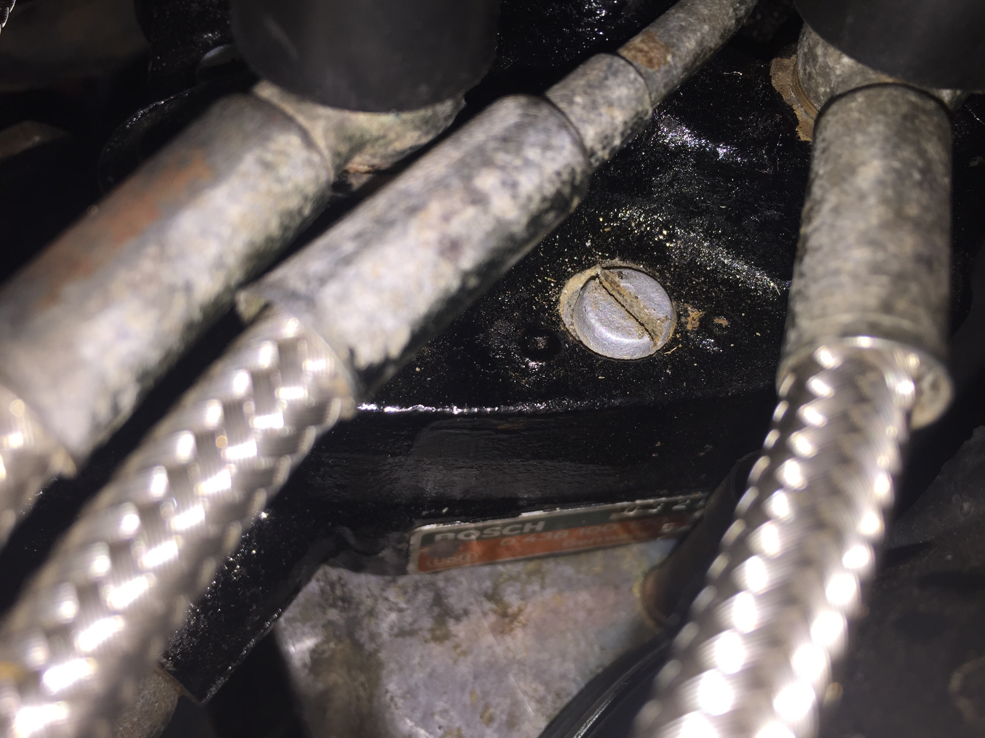

Right the problem is still there. Since my last post iv replaced the fuel pump and the accumulator.  Is doing my head in.. Need to try another metering head but can find one with the same part number.  Are they interchangeable? Can I just use anyone as long as it's from a dx engine code
Here's my part number
260 views (803 Kb)
Last edit: by Matt_20vt
190 views (1.54 Mb) Here's the other part number
I had the same problem and it was my metering head it would run rough and miss as soon as it was changed all was good. Contact funk-star aka mark @classicvw.co.uk or Kmi Bosch refurb them in letchworth.
