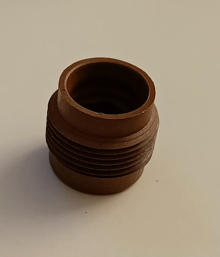

Hi was wondering if anyone could help me find out what the pitch thread size is on the injector seats on a dx engine as I know the diameter which is 24mm but need to find the pitch?  The reason for this is I need to buy the correct tap to see if I can re tap the threads as they are a little bit damaged.

Is this the  type you mean, the brownish plastic ones?
If so, this particular one's 1.5 (and also 24mm diameter).
Yes that's the one thankyou much appreciated 👍🏼

I've only seen Phenolic.
Brass have a larger internal diameter to allow shrouded injectors to fit, the 'top hats' make them that bit wider.
There's different plastic caps fit to the brass version to seal the injector hats.
There's also a version that's longer than the one pictured and entirely plastic, sort of halfway house between it and the brass one… seems to have been very short lived, 1984 for a year or thereabouts.
