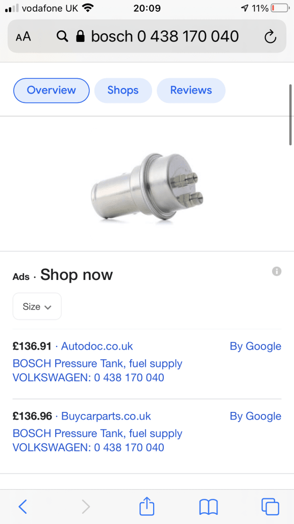

I need a new one and the Heriatage one is about £250.
I can get one of the above for half the price.
I know it's an old post but fingers crossed.
https://www.amazon.co.uk/gp/product/B004Z0UOK2/ref=ppx_yo_dt_b_asin_title_o06_s00?ie=UTF8&psc=1
