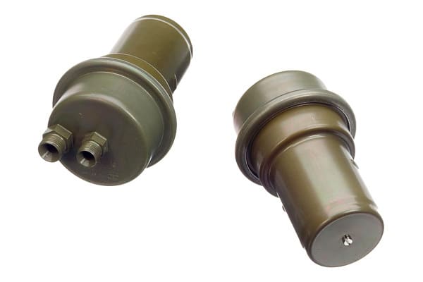

sporttrucker said
looks like this
Thanks, could this explain the intermittent nature of the re starting? Also note, that to date once started never fails until next restart. Has plenty of spark.

sporttrucker said
sounds like the fuel accumulator is broken. you can check it buy removing the small screw in the back if fuel comes out it is faulty
