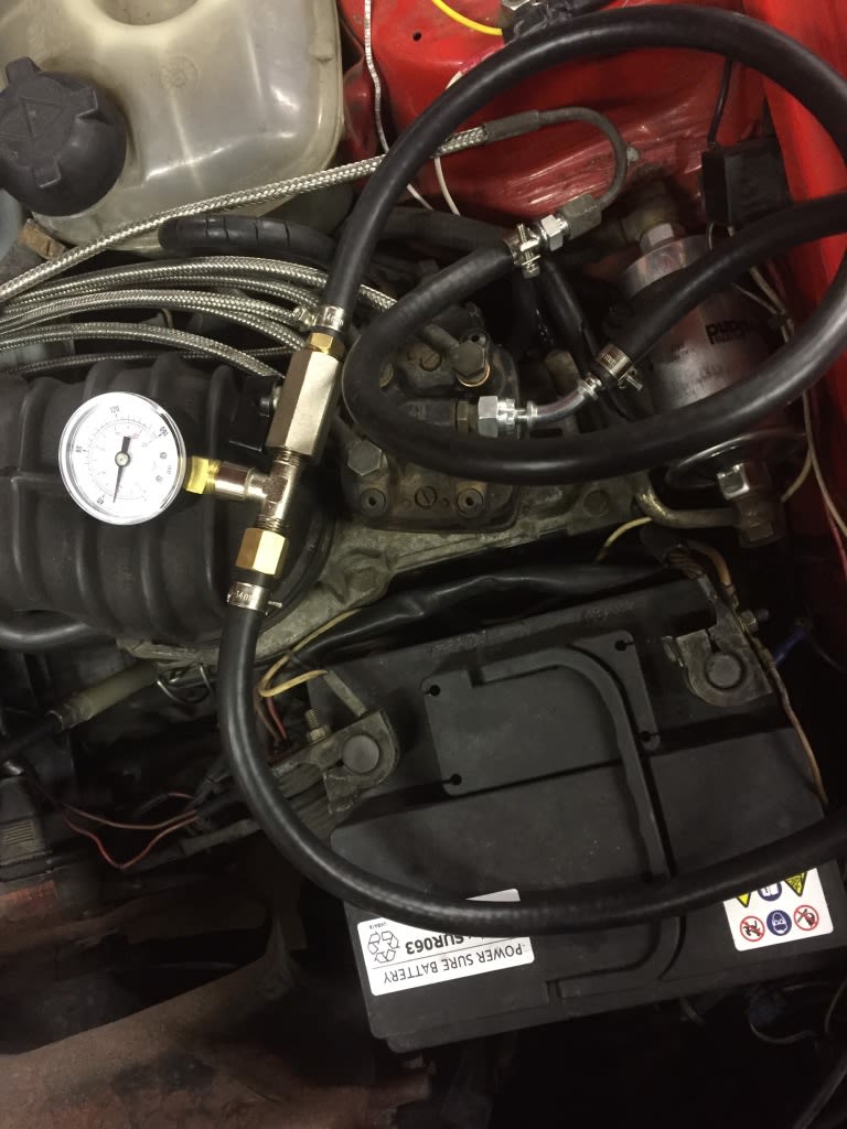

Think the only way forward is to beg/borrow/steal/buy a fuel pressure tester.
Any suggestion of a good source to buy a fuel pressure tester?
