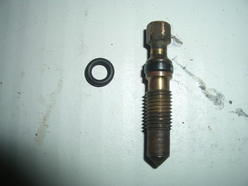

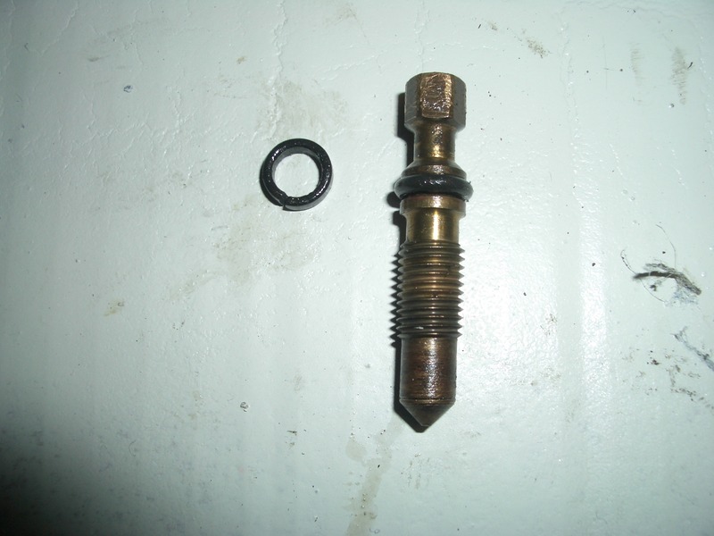

Have you checked the rubber o ring on the idle screw as they do go flat and let air in after time.
Old one with new o ring next to it
New o ring fitted with old next to it.
