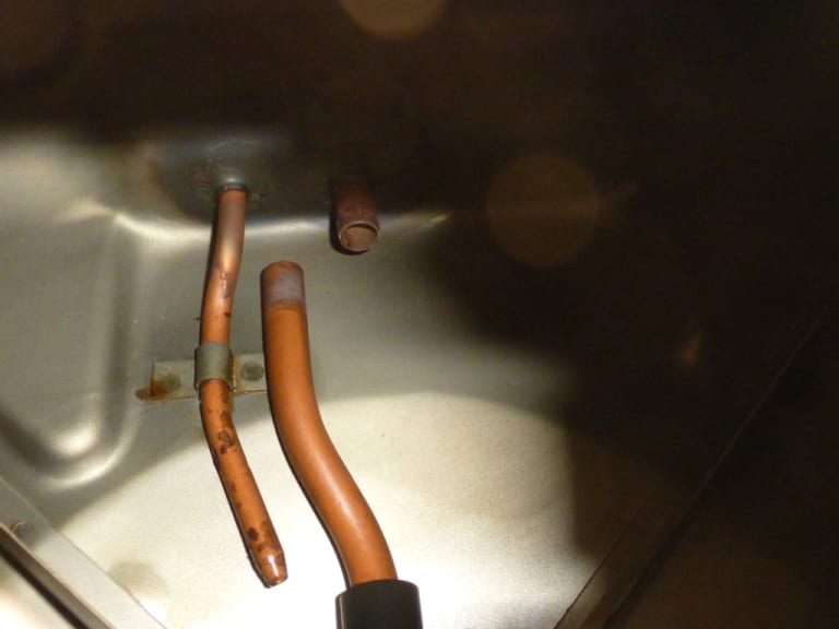

Yeah I'm starting to get the idea I've bought2 now on eBay and either there are rotten of the pipe has come off! I think I will have a go at repairing one, but not sure how that is going to pan out thanks again for taken the time to answer my post
Kris

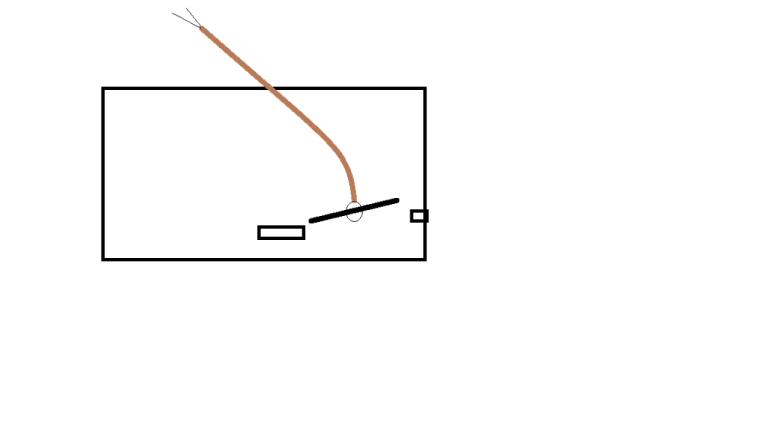

you could try and make a noose with some copper pipe and some string, bent to get to the swirl pot area in the tank. with that you should be able to get some rubber hose over the ends of the pipes, then pull one end of the string to get the snare tool off the pipe.
as for rust, small holes can be drilled out and pop rivted then painted over with petro patch, bigger holes can be welded if precautions are taken to remove the fuel vapours
Thanks I'll have a go and see where it goes, I have a tank on there at the moment just need to keep it topped up, now ideal but will do until I get the others fixed
