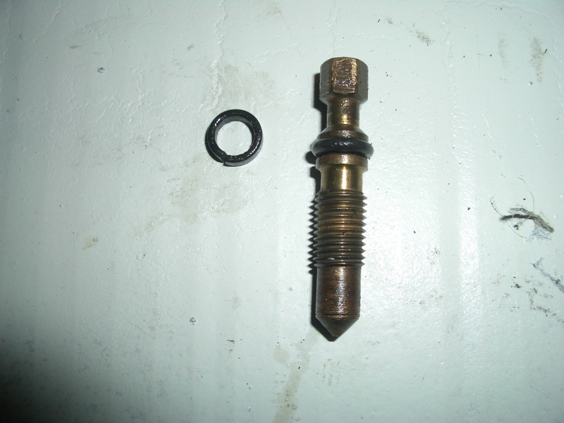

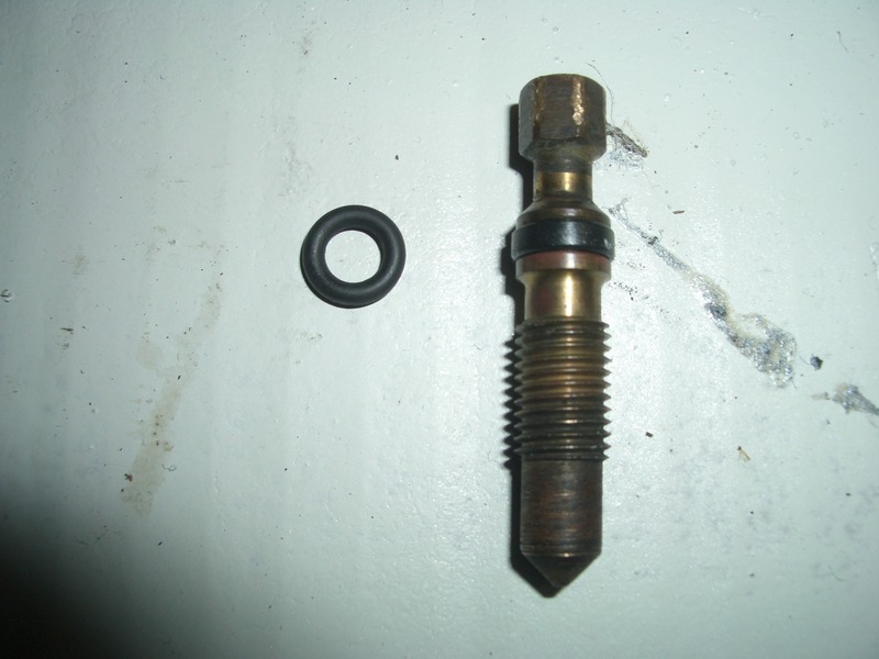

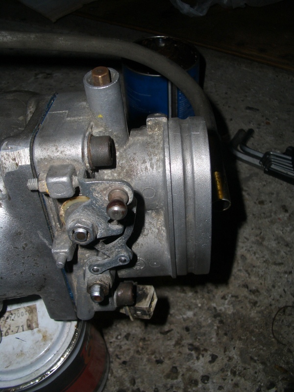

Try increasing the idle speed, the idle screw can work it self lose as the rubber o-ring gets old and flat.
Its at the back of the throttle body.
Old seal/ o ring
New seal/o ring
Last edit: by mark1gls
Mark the idle screw hasn't moved. A few years ago idle screw went 'missing' while on the QE bridge at dartford. Had to fill the hole with some old recipes out my wallet just to get home. When I got hold of another correct screw I wrapped it in ptfe tape and it hasn't budged since. Also if I increase the idle speed, my cold idle will increase to which atm is fine. I want to check the control pressure of the Wur but can't justify buying a gauge right now. I suppose another way is borrow a Wur off someone, swap it over, see if that solves it?
