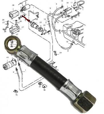

It seems I have a choice of 2 parts:
533201220 or
171201220D
Are they the same fitting and just depends on where I want to put the accumulator?

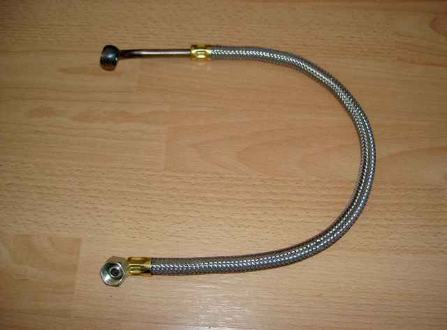

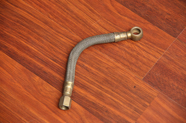

There seems to be a part that looks similar on ebay:
171201218D
However the seller thinks it is a fuel filter hose 171201218D ??. Can this part be used in place of the two I posted above, or is it a different fitting?
MOTY 2013
the banjo end on that hose is M14 unfortunately so it wont work on the fuel pump as thats M12. Unless you can replace the non-return valve on the fuel pump with one that has an M14 outlet
the short hose is reasonably flexible but dont push your luck!
