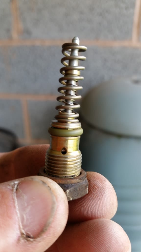

I took initial guidance from this thread on CGTI http://www.clubgti.com/showthread.php?279048-Long-start-issue-solved!
and the pic of his regulator
Mine looked like this
MOTY 2013
VAG Documents & Downloads
So how do you get that bit out then? I assume its pretty delicate

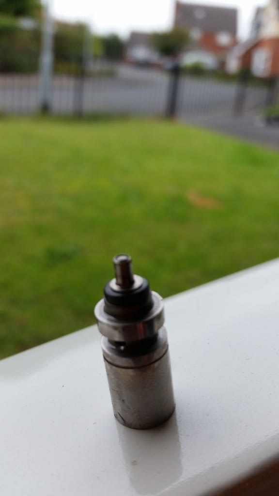

Ok here it is difficult to photo with phone as its so small, couple of shots
the grommet is decidedly square edged and in line with piston rather than round and proud. so should it be replaced
and with what, I assume a rubber grommet is a rubber grommet, just need the right dimensions>
3.68mm ID x 1.78mm CS for the tip and 6.78mm ID x 1.78mm CS at the other end - I used viton.

whod have thunk it.
I found this kickin around the garage ( on the right from and RC car) , looks about the right size .
may pop that in while i find another to see if it does the job
