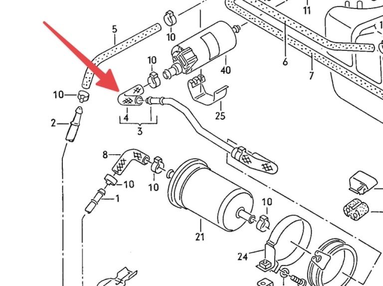

What do you use here?
Whip
/wip/
Noun - Car
E10 rated Fuel line just do a gentle bend, if you can't find a pre-bent one. pn 357 201 311   BE Sure to use Fuel hose clamps and not Jubilee.  They are also calling then Fuel injector clamps now-a-days.
You are on a 90 series so it can also be Fuel injector line, as the Pumps pressure is only 45 psi.
If it was cis, then that is rated at 75psi and why it requires banjo fittings.
I'm Cis now for the 9A, so it's going from the accumulator to the fuel line. It is currently set up with a pipe and clips.
I'm trying to think of a better way to attach it.
