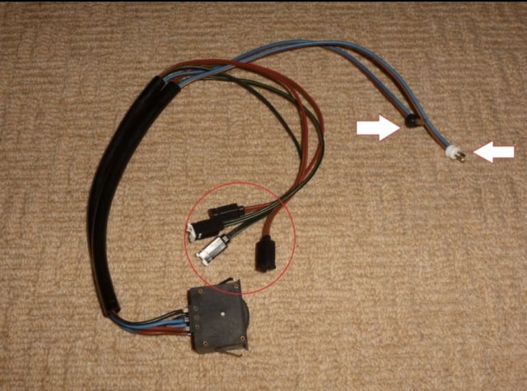

I've a complete one somewhere, I'll post a few pics of the wiring if your interested.
Yes mate, I'm curious now!

It allows for two additional speakers to be faded front to rear while the sets own controls would adjust sound left to right.
The wirings just spliced so mono doesn't suddenly become stereo or stereo become quadraphonic.
You can see it clearly in your pictures but in 'Mobys' pic his yellow circle is cover up the white speaker logo on the left I think.
That and his fader wheel must be all the way to the left or right, so not showing the white line down the center point.

Now that I've had a look at the wiring it's actually intended to convert a set with two speaker outputs to four speakers, though you could just as easily use half the wires and make a single output speaker set into a double.
The wirings just spliced so mono doesn't suddenly become stereo or stereo become quadraphonic.![]()
I missed a complete set up at Stanford Hall last year. Do you need yours? Will you use it again???
If you do, you'll also need the slightly different dash trim piece with the speaker emblems. The standard one still fits, but the opening is bigger and doesn't entirely cover the white speaker emblems on the switch itself as per the second image.
