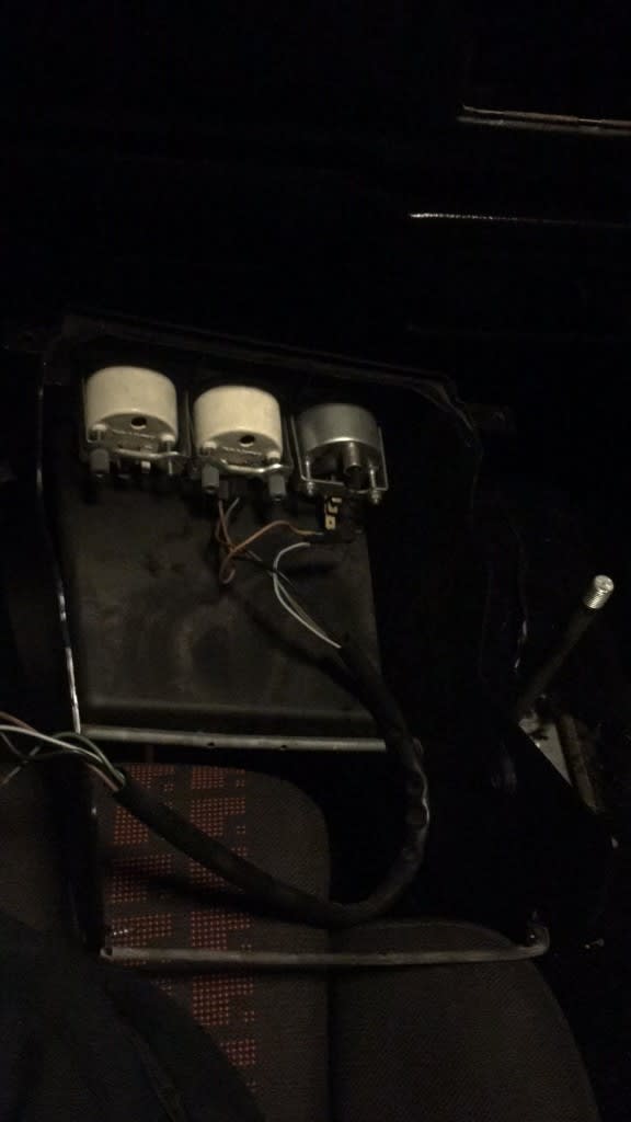

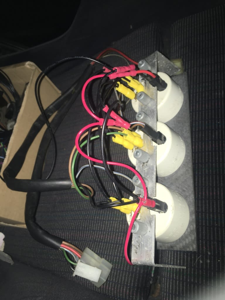

here is the easiest wiring diagram to double check but also there is a link for the back of fuse box bottom of this post that rubjonny sent me
i just took the switched live from G3 spade. much easier and direct.
https://clubgti.com/forums/index.php?threads/fusebox-faq.219775/
behind ash tray as yours mine was bodged by one of previous owners so contended wit that then took the headlight switch live by splicing the grey/blue wire from ciggy lighter (3 x 12v leds, also gain the dash dimmer function)
What I had to start with (were in boot when bought the car)
pics of start to new wiring
finished new loom (minus the 2 feeds from engine bay as i added these and connected once I replaced console)
fitted
Blue/grey from behind ciggy lighter def the headlight/dimmer for illumination
G3 spade deffo on back of fuse box
I'm waiting on the twin pole pressure sender and all should be sorted.
I got a new temp sensor and t-piece for the oil temp and that's on top of the oil filter housIng. As soon as sender turns up that's going in side of engine head
Last edit: by h3lter
