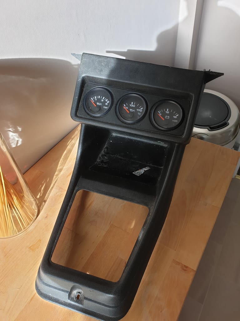

Hope everyone is well and staying safe.
What with all the free time I suddenly find myself with, I'm trying to fix some of the niggly issues my mk1 cab has!
First up, it's got a nice set of proper VDO gauges… but sadly the oil temp and pressure gauges dont work.

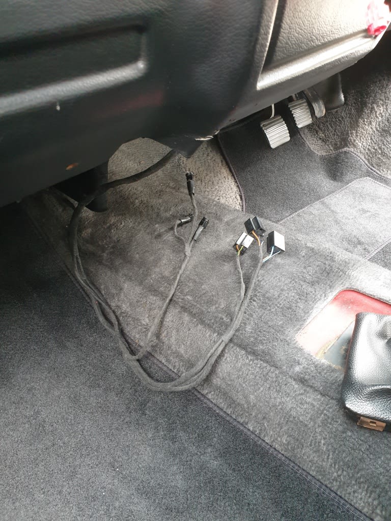

I whipped the lot out and found in the rats nest of wires that both wires that would go to the relevant senders went nowhere, so that explains that.
Figured I may as well start from scratch and make the loom up properly, soldered and wrapped in proper cloth loom tape rather than the twisted together bare wire abomination that the previous owner kindly left me. But that leaves me with a few questions if anyone can help…
Best live feed for them - assume ignition switch live, correct?
Where do the oil pressure and oil temp gauges get their feeds from? Some kind of sender? My MK1 is a none GTI so doesnt have an MFA therefore I'm stumped as to where they will go as my assumption is no MFA means no factory senders, right?
And finally since I'm doing the work I may as well renew the bulbs, anyone know what kind to do for? My old eyes cant make put the markings on the existing bulbs but they look like this:
Thanks all!

Just be sure that you use solder and heat shrink on the connections to make it, that is Crimp connectors are fine, but solder and heat shrink them are for-ever with no niggly bad crimps.
Not sure about the light loom though, the bulb holders look pretty specific bit I'm sure you could get around using generic bulb holders as long as they sat in the spaces and stayed in situ?
Anyone know how much my set is worth out of interest, Including the consol and both looms ready to drop in? Without senders assuming my car doesnt have any, the sleet is preventing me from looking right now!!!
Does this mean I dont have either sender I need?
Ta
Consoles go for £50-£75
This is the asking price. No idea if anyone gets a buyer.
Why, are you selling?
