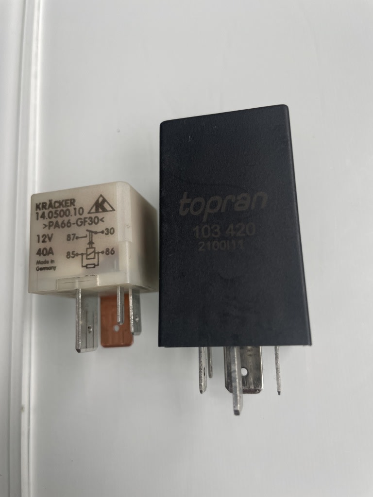

The fuel pump is running constantly, blower and wipers not working, I bought the car like this thinking the relays probably need changing.
The car came with the relays as they are in the image.
If I swap the 17 relay with HELLA, the fuel pump stops working and the wipers work only at the highest setting the blower still doesnt work.
I bought a couple of fuel pump replays but these do nothing?? I have tested the relays for continuity and the click, they are both fine.

The car won't start with any of the other relays. It only starts with 17 in its current position which isn't where it supposed to be.
Are these new relays correct for this car?

I actually bought 2 of the Topran thinking is was faulty but both don't work!
There are known issues with them running all the time is one.

Relay 19 is however faulty( I have ordered another).

I purchased another fuel pump relay HELLA 321-906-059/F from heritage was abit pricey but the car now runs as it should with no continuous fuel pump running👍

The new wiper relay (19) works i now have wipers working in all positions.
