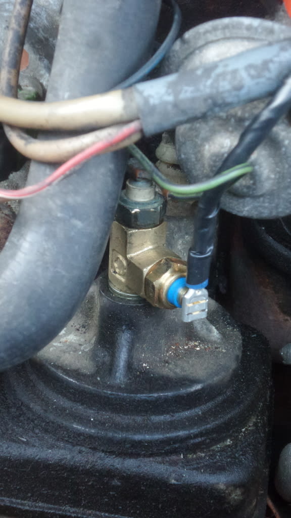

Genuine VDO Dual sensor 0,25 bar warning light and 5bar rating for the gauge output with m10x1 threading found on ebay and the temp sensor 0-170 defrees blue version also m10x1.
Installed the temp sensor in the spare plug on top of the oil filter housing
Plug and play and thats done

One point to make is that if your clocks have MFA then you need a T-piece to allow you to run 2 temp senders from the top of the oil filter housing.
There really isnt much room at all and this is the only one I could find that would fit.
Its 1/8NPT as opposed to 10mm but it equates to less than 0.2mm difference in thread pitch so will still fit

Sorry I forgot to mension that I do not have MFA, I was not aware of the space-issue for those of you who doesnt have the empty space in the housing. Thanks for correcting.
