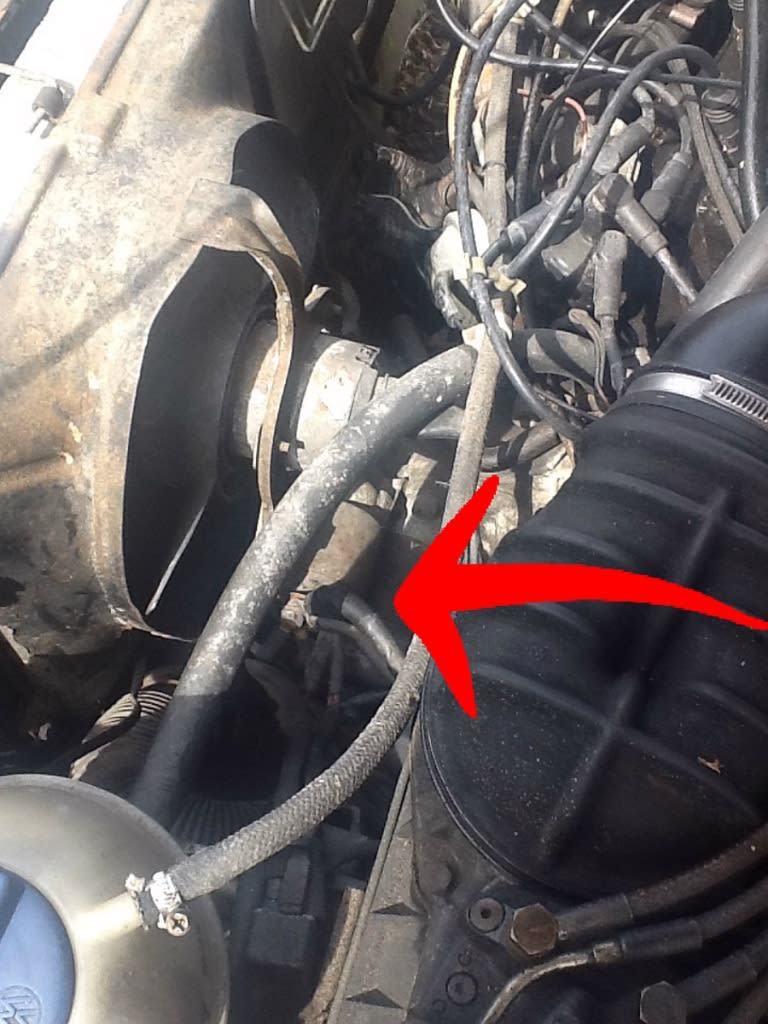

Battery moved to rear, engine bay, Battery earths
The earths that usually go to the battery are screwed on the frame at front, where the batery earth strap is located
Battery moved to rear, engine bay, Battery lives
These are all screwed onto the starter
Conclusion
I'll include pics, one of engine bay for orientation, and anothe with the arrow pointing to lives located on starter motor.

When you moved your cables to the rear what did you do with the "Extra" cables that were attached usually to the Positive Terminal as in the Extra Take offs leading back to the fuse panel, and or the ring connectors that were attached to the positive battery post? It could very well be one of those additional wires as one feeds the Fuse Panel on the 30 circuit.
All these that ussually were on the battery positive were re routed to the starter motor, as my 2nd picture
