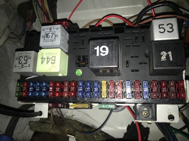

Checking over wiring before starting her up for the first time in years & after a 1.8t conversion. Battery is new & checked it's good with multimeter. Earths from battery & gearbox to chassis are new cables to fresh metal. Yet after connecting the battery I have absolutely no power, no lights, nothing at all, not even the obligatory little spark when connecting the battery up.
1987 Cabriolet (was carb)
Checked alternator wiring. New starter fitted & checked wiring. Only thing strange I can see is the previous owner has put in 53 & 644 relays in the fusebox bottom left? I have checked the fusebox faq & they look odd there. Anyone have any ideas on the relays or what I can check next please?

slot 7 is only needed for front fogs, and only then if the fog light power grey/yellow jumper wire has been moved from M plug to the spare grey/yellow hanging out the fusebox. (in short, 53 relay in there is fine regardless)
644 relay is newest version of 17/18 X relay so that is also ok
check spade P on rear of fusebox that should have 1 thick red from battery and another to ignition switch. look on plug D, the brown wire with spade out the back needs to go on the white 4 way spade block, which hangs off the thick brown wire from the battery negative. the spade block also has a brown wire with spade out the back which needs to go to the earth claw above fusebox

D/22 you should have 1 wire off to the wiper motor, the other needs a decent earth how it is should be fine, you'll just need to earth your wiper motor brown wire somewhere else, claw or white block is fine.
the battery earth should end in the white 4 way spade block I mention, this has a wire out the back which goes to the claw to give those a good earth. then in the front side you would have the D plug spade, fuel pump spade, dash spade and whatever else needs the best possible earth. everything else goes up to the claw.
1st check is do you have good battery voltage at the P spades, then check again at the red wire on ignition switch. then switch ignition on, check if you have good voltage at the black and black/yellow wires. chase the black back to fusebox, check you still have good voltage here, along the way look out for any previous bodgery to ignition switch wiring.
to test if your engine earth and starter power is good enough jump a thick wire from the live stud on starter to the trigger spade/plug. if it cranks over nice and fast, this is all fine. if not, run a jump lead from battery earth to one of the bolts holding starter on. if it cranks over better then you need a decent earth from battery to engine bay, I've seen a few guys struggle when the battery is only earthed in the boot.
to test if your shell is earthed well enough check voltage between battery and bare metal points in various places. near battery, stud on the A pillar, engine bay where your chassis earth is etc, if you get decent battery voltage then all is well here (but starter may still not be happy with an earth thru the shell)
repeat test between 12v supply and your earth claw(s) to make sure those are also well earthed.
As you say I would suggest you run a good live and earth from the battery to the fusebox as well

It's just dawned on me what the problem is. It was your earlier question Rubjonny that made me realise the answer so big thanks there. You asked if there was a wire from P block to battery & I said no to the alternator. So the battery goes to starter & alt/ignition goes to fusebox, nothing is connecting the two. I put a thick cable between starter & alternator & everything powered up, yahoo!
