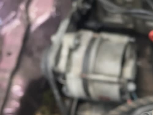

Mk1 golf gti
( alternator i want to instal in the polished one)

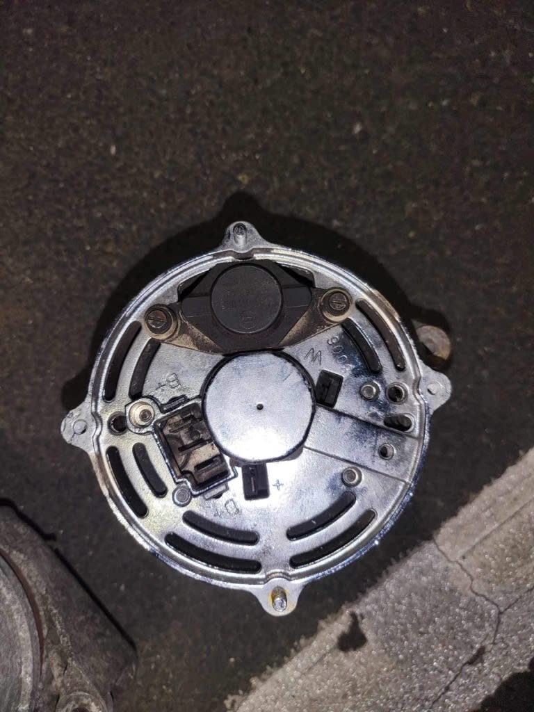

There's the 2 slot head screws which hold the regulator on.
New one here but check it's the right one and check yours on either alternator before ordering one, lots on eBay etc.
https://www.ebay.co.uk/itm/175736458678?fits=Plat_Gen%3AMK+I%7CModel%3AGolf&epid=249096940&hash=item28eab58db6:g:6~MAAOSw3ZFftqlB&amdata=enc%3AAQAIAAAA8EydTLdBXfyFXuLGcE7g4JCdAoPAmIXxQ9PApjuyUwvcMumnDubU%2FdXzoXBY6nxXrRTOvd75qoJWE7qTrHmLmftOs1ydxkYxTOujc7kHr7w9JH5If0pQubvfrjPi3bptIuK59rJYwZH55s4Hnu2aPk7jxb29OI0gopgSXKYCseBYpfbxvT8NgQr2V23gV7hBZ7JhDJwLKG0OIHImqqfWm6DupvV9W1rw12tJ7ZAzU%2B5A00g0YuxURhEXbZpmmHewLq4%2Fbp6rTEUqePIPkGWSsRFk3MdJb4lgi8ALmqkOVZo9o195AYOV2T6MqbMCEmHwJg%3D%3D%7Ctkp%3ABk9SR9rNsdGjYg
The Plugs is for 2 wires Hot +12V, and the little one for the blue exciter circuit. Both +12 usually ran back to the battery. Some ran from the Alternator to the starter then to the battery.
