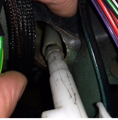

Make sure it is clipped snuggly.
Briano1234 said
I have had the cable squeal like a pig when it was cold. Once the cabin was warm it would stop. Scared the bejeezers the first time. Spraying the internal cable with TRI-FLOW helped me stop it but I had to respray about every 2 years….
My brother had a MK2 1.3 Golf C back in the day and it made a clicking/ticking sound from behind the clocks on a frosty mornings that stopped as the car warmed up. Becasue it wasn't a permenant problem he just put up with it.
It's always another potion with you
it's definitely clipped on, it does seem to be related to temperature, and did scare the bejeezers out of me.
Does it have to be TRI-FLOW or will any PTFE lube do? It's bloody expensive here.

Since I have an auto I can remove it from the tranny easily…not that way on some manuals as you drop the gear…. I would stay at the speedo side.
Or do I have to take this off?

Soak it good.

you could also do the fist pic, but the second is where the cable is.

On my automatic, I could take the center out easily, clean the snot out of the cable and plugged the sheath inside the cabin, then sprayed the hooty out of the cable and the sheath, re-insert and it didn't come back.
Manuals are a tad different…than the ease that you can take a automatic cable on and off.
Briano1234 said
It's the cable, and may take a while to work about.
Yeah, starting to go away now. Thanks
