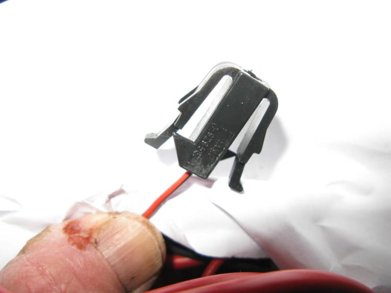

Photo's taken this morning showing the blue/grey connector that comes from the oiil temp sender and splits over to the dash that should plug into the rear of the fuse box. Second picture is the floaring connector red cable that is perhaps intended as a spare live ? the blue/grey is almost certainly the feed to MFA oil temperature and should be plugged into the rear of the fuse box
Thanks Guy
Thanks Guy
Second black connector picture
Guy
Guy
